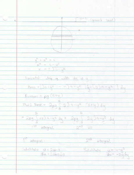

1. The problem statement, all variables and given/known data
A circular "pressure release gate" is located in the vertical face of a dam. The radius of the gate is 2 metres and the gate is positioned so that its top lies 5 metres below the surface of the water held in the reservoir behind the dam.Find the total fluid force acting on the door of the gate, when it is in a fully closed position.
2. Relevant equations
Area= [tex]2\sqrt{4-x^2}[/tex] dy
Pressure = pg(5+x)
3. The attempt at a solution
F= pg∫ [tex]2\sqrt{4-x^2}[/tex] (5+x) dy

Feb18-09, 04:16 AM   #2
Blog Entries: 27
Recognitions:
Gold Membership Gold Member
Homework Helper Homework Help
Science Advisor Science Advisor
Quote by Nyasha View Post
Hi Nyasha!
(have a square-root: √ and a rho: ρ )
almost right , but the area of the slice is 2√(4 - y2) dy, at depth 5+y

Feb18-09, 03:04 PM   #15
Quote by tiny-tim View Post
Hi nyasha!
(you can put π/2 into the integral with ^{\pi /2} )
You don't like undoing those brackets, do you?
It's a combination of cos2θ and cos2θsinθ.
No, sin2θ = 2sinθcosθ, but it doesn't work for sin8θ.
btw, going back to the original integral, it would have been simpler to just integrate x√(4 - x2) and √(4 - x2) separately, without substituting …
and shouldn't the limits have been -2 to +2?
If we integrate x√(4 - x2) and √(4 - x2) separately then do we need x=Rsinθ. The question says in order to evaluate the integral l will need the use the formula of disk of radius "R" where x=Rsinθ.
How did you get your limits to be -2 to +2 ?
[tex] pg\int_0^{\pi /2} {4\cos\theta}(5+2sin\theta)2cosd\theta
[/tex]
Is this integral correct ?
Feb23-09, 04:58 PM   #16
According to the solutions manual when l evaluate one of my integrals l should get zero. What am l doing wrong on this question ? Please help.
Feb23-09, 05:20 PM   #17
Blog Entries: 27
Recognitions:
Hi Nyasha!
Your integral (from 0 to 2) is only over the top half of the gate …
you need to integrate from -2 to 2.
