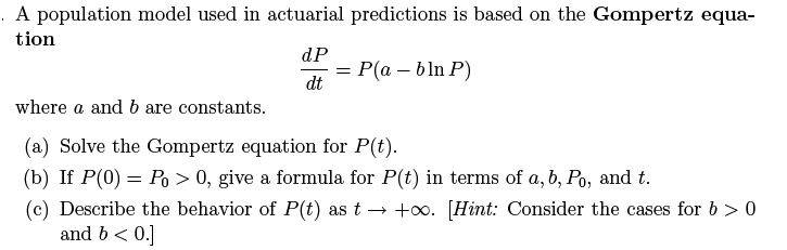

Second part of Part C is: Use mathematica to draw graphs for a few values of the parameters. [ Consider the cases b > 0 and b< 0]
I think you use the answer to Part A
Not sure how to graph with mathematica with parameters
You don't, that's why it says "for a few values of the parameters."
So you can use your favorite method to assign the parameters,
varying from the ugly
Code:
a = 1;
b = -1;
A = 6;
Plot[P[t], {t, .., ...}]
or the better
Code:
Block[
 {a = 1, b = -1, A = 6},
to my preferred
Code:
Plot[P[t] /. {a -> 1, b -> -1, A -> 6}, {t, .., ...}]
Using something like
Code:
Plot[P[t] /. {a -> {1, 2, 3, 4}, b -> 1, A -> -2} // Evaluate, {t, 1,
  6}]
you can even plot multiple ones in the same plot.
