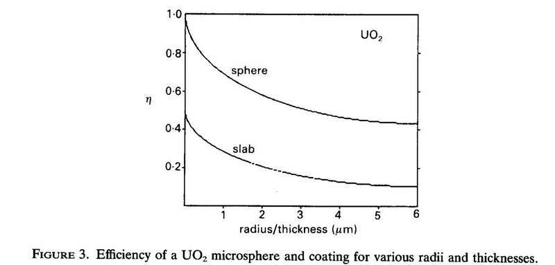

Here we go: With UO2 microsphere's Prelas theorizes 50 to 80% of the kinetic energy can escape the sphere before thermalizing, figure attached.
http://prelas.nuclear.missouri.edu/Publications/NDF.pdf
Prelas et al 1987 said:
...for scaling nuclear energy conversion systems with reasonable efficiencies. One of the reasons for this optimism is that theoretical estimates suggest that 50 to 80% of the energy generated in micropellet will be available to [pump a lasing material, excite an excimer, etc]
Brackets are mine.Then there's the efficiency of the Fluorescer (30-50%) and the efficiency of the PV to consider, which apparently can reach 97% with monochromatic light at these wavelengths. https://mospace.umsystem.edu/xmlui/...5/769/NuclearEnergyConversion.ppt?sequence=5". Thus Prelas claims a 30-40% over all direct conversion efficiency from a fission reactor (much higher from simpler radioisotope devices), which then can be supplemented with a traditional heat cycle the overall system efficiency can reach "50-70%".
Ok, so if I have it right, we have a scintillating fluid (and coolant ?) in which there are suspended microspheres of fuel. This scintillating fluid emits light, and this is then captured in a 4-pi sphere of PV cells.
Now, this implies that the spheres are so thinly distributed that they hardly absorb any light (you don't want to have some dark black muddy stuff, right ?).
Next, this implies that you have or your PV into the reactor fluid (and hence exposed to very high radiation levels), or it implies that you have a transparant reactor vessel and radiation protection (uh!). Ok, this last bit could be achieved by a large swimming pool. But now, the surface to be covered by PV is rather large.
So the final design looks like a big light bulb: a transparant reactor vessel with a fluid inside with some suspended UO2 microspheres, suspended in the middle of a large swimming pool on the walls of which the PV are placed. I don't know if this is workable. The transparent reactor vessel sounds scary to me :-)
The abscissa in the cited figure, 0-6 microns, is on the order of typical grain size in UO2 ceramic pellets. Sphere-pac fuel uses microspheres of larger size - 50-200 microns diameter - and these produce a pretty tightly packed column. Fast reactor fuel pins are on the order of 6 mm, and pellet OD of standard 17x17 PWR fuel is about 8.2 mm. At normal fuel power densities, the fuel surface is about 400°C, and futher in, near the center of the pellet, the temperature is in the range of 900-1200°C depending on the power level.
Add to that the high gamma field, I can't imagine that PV's function well. The Compton and photoelectric effects would result in considerable ionization in the PV material. I wonder if Prelas has placed a PV in a high rad field at 300°C and measured it's performance.
I've read about nuclear lightbulb concepts. Some are pretty wacky, and conveniently ignore reality.
It helps get you funding if you make ideal assumptions. :smile:
Astronuc said:
... Prelas has placed a PV in a high rad field at 300°C and measured it's performance...
Recall that optimistically 80% of the energy escapes the Prelas fuel spheres into the flourescer (sp? his term) material so we would not expect high temperatures in the fuel.
The surface covered by UV mirrors is rather large. The PVs can be down at the end of some wave guide. Same trick commercial solar PV concentrators use.
