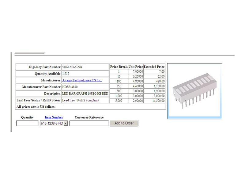

What is the pin spacing? 0.1"? It looks a lot like a plug-in LED bar graph display. I have usually seen them with 10 LEDs in a row. Does the attached picture look anything like yours?
yes that is a led thing. the pin spacing matches protoboard squares if that's the question. and its not the led thing but the red thing that i was confused about.
The red thing could be a resistor strip for current limiting the LEDs. I would take an ohm meter and see what the resistors are. There could be one common (where?) and 8 parallel resistors. I will guess about 6 volts/.01 amps = 600 ohms.
