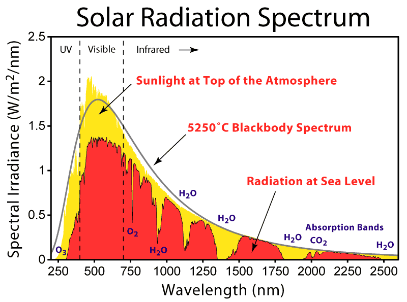

If this is a typical silicon PV cell, it will absorb wavelengths shorter than 1.1 μm. Not sure offhand what fraction of the sun's energy this is.
From eyeballing the red area in this graph, looks like about 75-80% of the solar spectrum is less than the 1.1 μm cutoff of a silicon PV cell.
While rejecting the 25% or so unusable part of the spectrum could offer some heat reduction, one has to consider if it is worth the expense.
A question I have is, to what extent are the longer wavelengths absorbed and heat the cell? Or is silicon simply transparent there? If that's the case, then there really is no need to worry about heating by the longer wavelengths.
EDIT: the above graph is from here:
http://en.wikipedia.org/wiki/Solar_radiation#Composition
