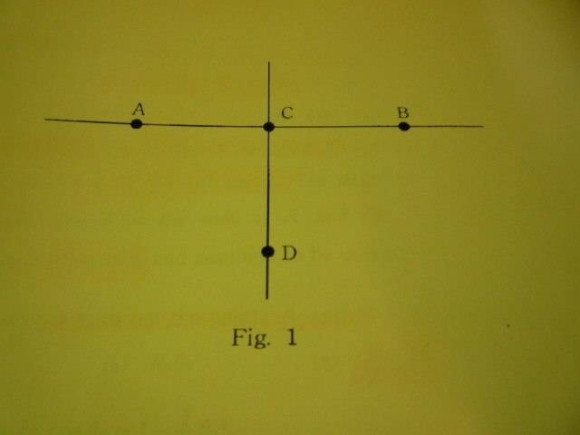

I draw two circles around the A and B. I let A's electric field go to anticlockwise direction, while that of B to clockwise direction.
I got the result that electric field points from D to C.
However, my answer is wrong.

What do you mean anticlockwise and clockwise? The electrostatic field of a point charge points radially. If the charge is positive, it points outward radially. If the charge is negative, it points inward radially. The magnitude is proportional to q/r².
Thank you for your answer!
I got finally that the electric field is from A to B.
I had confused electric field apparently with Magnetic field.
The key in allowing me to understand the problem was to set a positive test mass between two charges.
