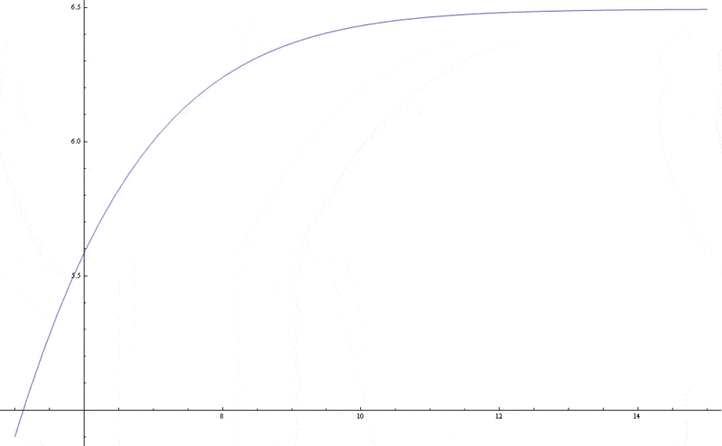

The attached plot may be useful - it represents
[tex]F = \int^{x}_{0} \frac{s^3}{e^s-1}ds[/tex]
F is the vertical axis, x is the horizontal axis.

When my attachment in the previous post is up, you should be able to calculate answers for this integral for a fairly wide range of [tex]\lambda[/tex].
