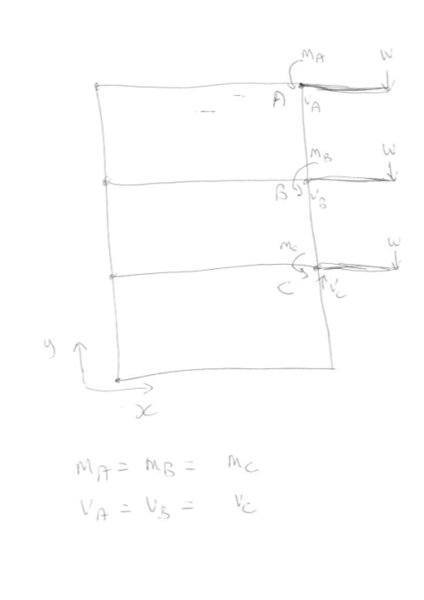

I am sorry to disillusion you but a bending moment is a true moment.
If you take the case of the root an encastre cantilever, there are two support reactions.
One of these is a moment, not a force, nor yet a couple. In other cases a bending moment may be the result of a couple.
Don't be sorry, I'm quite illusioned! You introduced the qualifier "Bending". I don't disagree that this is a moment, but it's a distinction, a certain way to look at a moment. My point was, there is no need to introduce Bending Moment into our discussion, as Moment did just fine, and it has not changed your argument. A torque is still a moment.
Show me an example, online.

Here is a simple plane frame, with three identical cantilevers, loaded with weights, W.
I have chosen to place the origin at the bottom left hand corner, so all position vectors are measured from here, by definition.
I have shown the support reactions for each cantilever (of course they are all equal).
However since the cantilevers are located in different places the postion vectors to their respective roots, A, B and C are different.
I repeat, despite different position vectors their support reaction moments are identical.
Why do I need three dimensions to analyse this frame? All the necessary analysis is independent of the third, z, axis.
What benefit do I derive from employing position vectors in the analysis?
It is true that for instance the method of tension coefficients (which does use position vectors) might be employed.
Your other claim is that torque and moment and couples are identical.
Please describe the two forces required to create a couple acting at A, B and C
If a moment or couple were applied to a cantilever in a plane parallel to the yz plane this would produce a torque on the cantilever about the x axis. This effect of this torque would be felt all along the cantilever, not just in the plane where it is applied.
Would the support reaction moments have any such effect anywhere else on the z axis, other than in the plane of the frame? Obviously not.
I think that covers all your beefs.
I never said you need 3 dimensions to analyze a frame. I said a Moment requires 3 dimensions to be a Moment. You can very well call that a position vector and that a force vector, and then talk about Moments, but what you're really talking about is the magnitude of a Moment. Once you cross these vectors to find an ACTUAL Moment, you get a third dimension. A true Moment is not required to analyze this plane. Only the magnitude. You have not demonstrated a moment. Which, once again, brings us back to your misunderstanding of what a Moment is.
It's not a benefit. It's a necessity, if you're talking about actual Moments. If you are analyzing Moments in 2-d, you're doing so for simplicity, and you're getting magnitudes of Moments. Just as, by showing the forces to be parallel to x/y axes, you're gaining simplicity in the analysis. But you should understand, that's not a moment until that Moment vector is projected into the z plane. In your example, you're talking about a scalar quantity of moment. A magnitude. Not a vector quantity. It's convenient to use 2-d for analysis. But remember, real cantilevers in real life occupy real (3-d) space.
I'll respond to the rest of this when i get home. Will you answer the questions I've asked? Will you provide evidence of your understanding that a Moment doesn't require 3 dimensions and a position vector? My guess is you will ignore these once again. You're not getting anywhere, Studiot, and you're continuing to propagate misinformation by refusing to back up your incorrect understanding of what a moment requires, and the rest of the issues I've elucidated. Do you disagree? The prove it.
No, it in no way does. You could simply answer yes/no to the questions in my last reply. That's all this thread needs at this point.
