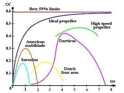

Jun8-09, 12:58 PM   #5
Quote by HydroGuy View Post
What I am more interested in, though, is the power transferred to a turbine. Obviously the turbine won't be 100% efficient, so that will invoke some constant. But could I logically say that the power AVAILABLE to the turbine would be the total area swept by the turbine blades (picture wind turbine blades rotating) or would it only be the physical area of the blades looking into the rotor?
You need to include the efficiency of the rotor/blade design. There is a theoretical limit of about 59%, and then efficiency of real devices improves as tip to stream speed ratio increases.
See the attached plot for alpha. This alpha factor will scale your power equation.

Jun9-09, 12:44 PM   #12
Thanks for the help guys. I'm still trying to figure out if Betz' limit for efficiency of wind turbines applies to hydro turbines as well.

Found an excellent article that cleared a few things up here: http://www.carbontrust.co.uk/technol.../ME_guide3.htm
It appears that Betz law DOES apply in the case of hydrokinetic turbines as well - in the end, this does make sense as if you took ALL the energy out of the current, the exiting velocity would be 0 m/s and the blades would not turn.
It also describes how more blades equals more torque, especially at lower speeds, but lower RPM's. The coefficient of performance, Cp, is what I want to maximize for my turbine. This depends heavily on the tip speed ratio, or TSR. This is the ratio of the linear velocity of the tip of the blade, Vt, to the velocity of the river, Vfs.
TSR = Vt / Vfs
And Vt = w * r (w=angular velocity, r=radius)
A question: can the angular velocity of the turbine tip ever exceed the velocity of the river? I think I heard somewhere that it can't...
To maximize Cp at varying velocities, they recommend varying the blade pitch, but this would add considerable complexity and consume power, so I'm not sure its very realistic for small or medium size hydrokinetic units.
