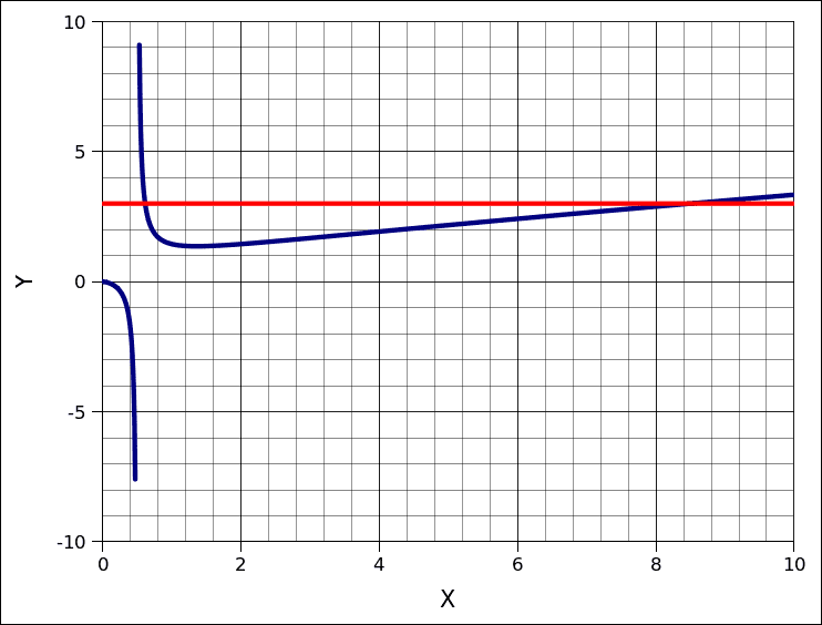

Hello qraal,
Using the method of Newton-Raphson will give you a fast approximate solution if you have a "good" starting value in the neighbourhood of the solution. The method can be found here:
http://en.wikipedia.org/wiki/Newton's_method
and is for your equation:
[tex]x_{n+1}=x_{n}+\frac{ln(2x_{n})[yln(2x_n)-x_n]}{ln(2x_n)-1}[/tex]
The problem is that the function
[tex]\frac{x}{ln(2x)}[/tex]
is diverging for x=0.5. For values smaller than 0.5 it is negative and for values larger than 0.5 it is positive. However for the positive values it has a minimum and thus two solutions if a y-value is given. So the initial value is best to be determined by plotting it.
As an example use rock.freak667 value of 3. This has two solutions, one in the neighbourhood of x=0.6 and one in the neighboorhood of x=8. These serve as starting values in the iterative scheme and give you very quickly the solutions. I have the following values: x=0.613444 and x=8.499444. I added also a graph of the function to clearify things. If you have any questions please post.
best regards,

Hello qraal,
If the x-values are larger than 2 it has a unique solution. In case these can be between 1 an 2 as well you will have two solutions. This is clear from the picture and a substitution in the equation. Indeed, we have for x=1
[tex]y(1)=\frac{1}{ln(2)}[/tex]
whichis the same value for x=2. In between these a minimum exists for
[tex]x=\frac{e}{2}[/tex]
and the y-value is here
[tex]y=\frac{e}{2}[/tex]
So you must have y to be at least e/2 to have a solution. I would suggest to use a large initial value if you know that x>2 or y>1/ln(2) and in case y<1/ln(2) this large value will give one solution, the other can be obtained by setting the initial value to 1.05. Nice equation to study :-)
