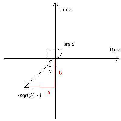

2. for part(iii), i can see that the complex number is in the third quadrant...and i know that tan there is negative and and the angle there is found by pi + (the related angle)...i know also that arctan[1/(sqrt3)] = pi/6...i know also that arctan is restricted between -pi and pi...
so how was arg(z) found to be -5pi/6...?...
why is theta shown to be projected anticlockwise this time...?...

For number 3, see my image. Consider the easier problem of calculating the angle v. We see that |a| = sqrt(3), and |b| = 1. Thus tan(v) = a/b = sqrt(3)/1, which implies v = pi/3 (since we can see that 0 < v < pi/2). The relationship between v and arg(z) is: v + arg(z) = 270 degrees = 270pi/180 radians = 3pi/2. So arg(z) = 3pi/2 - v = 3pi/2 - pi/3 = 7pi/6, which is "the same angle" as -5pi/6. I'm not sure why the choose to make it anticlockwise though... tan is not negative in the third quadrant btw.

thank you very much...i'm still trying to get my head round this...
sorry, for question 3, i meant to say that theta was projected clockwise...
1. okay how do we know that 7pi/6 is the same as -5pi/6...?...
2. why the different projections of theta - i mean anti-clockwise for the first two complex numbers and clockwise for the other two...?...

arg is a multivalued "function"; each input gives lots of outputs.
Arg is specifically restricted to a particular range... (-pi, pi] I think. Thus, you have to pick the one output that lies in this range.

Knowing that the "base" angle is pi/6 but that the angle is in the third quadrant, you could either add pi: pi+ pi/6= 7pi/6 or subtract pi:
pi/6- pi= -5pi/6. Since your problem specified (more or less arbitrarily) that the angle must be between pi and -pi, the second is appropriate for this problem. Of course the two differ by 2pi so they are really the same.
