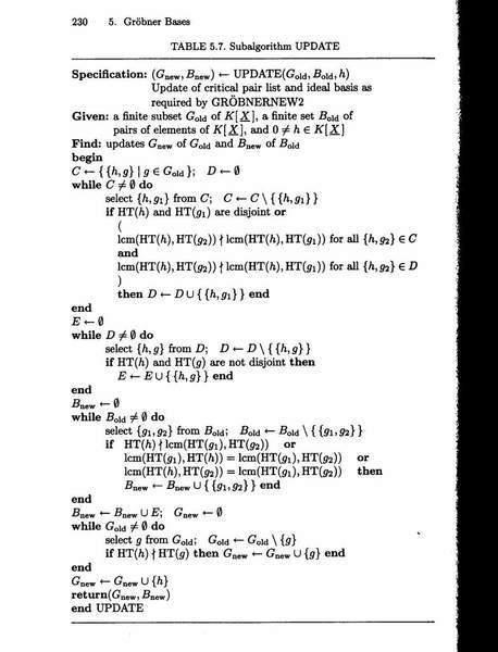

Before entering the second while-loop the algorithm runs through the first while-loop for two times calling the Update function each time. I have attached this function in the file update.jpg. As you can see each time the function is called with a particular polynomial h this polynomial will end up in G_new, and thereby in the set G of the F4 algorithm (third to last line in update.jpg). Which polynomial Update is called with depends on the first() function in the F4 algorithm. In my opinion when cycling through the first while-loop first() should return f_4 and then f_3. Thus the set G would have to contain f_3 when the second while-loop is entered. I have specified what I think should be going on in specification.pdf. Could anyone explain to me whether and if so why my reasoning is wrong?

I'm afraid I do not know a lot about this algorithm, but I believe that G={f_1,f_2,f_3,f_4} before the second while loop is entered. The first while loop does not stop until F is empty. It is also pretty clear that the labelling of f_1 to f_4 are backwards in the paper on page 14 -- that is, f_4 is in fact a+b+c+d, since the first pair selected with the normal selection strategy will be the pair with head terms ab and a. Howver, given the set T(F_1) in the same paragraph of page 14, only f_4 is needed to reduce the matrix; f_3 can also be used but the reduction it does, of ab, is also done by f_4. The important part is that the other elements of G are not germaine at this point, so perhaps that is why he left them off the dicsussion.
