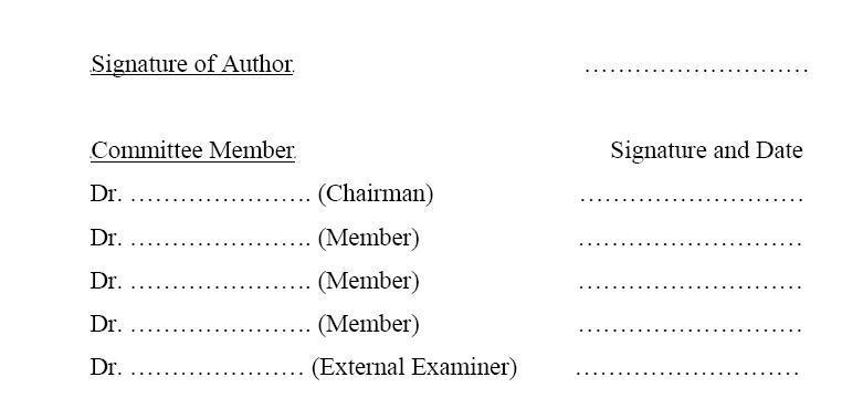

Hello,
How to write the following using the Latex program:
Thanks in advance

Try this out and see if it works for you. The column widths and vertical spaces are adjustable.
Code:
\newlength{\vertspace}
\setlength{\vertspace}{5pt}
\begin{tabular}{p{2in} p{1.5in} p{2in}}
	\underline{Signature of Author} && \dotfill\\[12pt]
	\underline{Committee Member} && \hfill Signature and Date\\[\vertspace]
	Dr. \dotfill &(Chairman) & \dotfill\\[\vertspace]
	Dr. \dotfill &(Member) & \dotfill\\[\vertspace]
	Dr. \dotfill &(External Examiner) & \dotfill\\
\end{tabular}

This is great. Exactly matching what I want. Do you know what? This program (Latex) is a great one once you get use of it. Thank you very much Fenn. Wish you luck.
