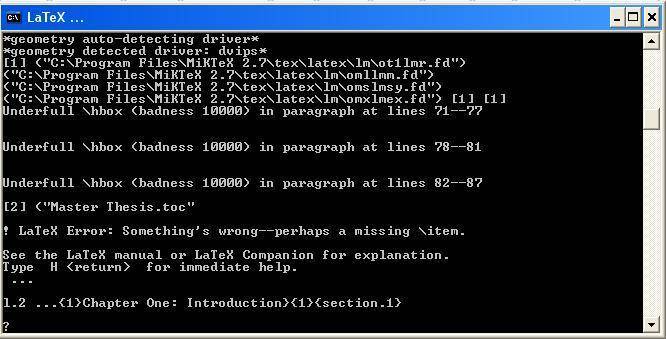

Furthermore, when I write \tableofcontents, the following error eppears:
Why is this error? Even though I put it the first time it worked, but later on stopped working, I don't know why?!

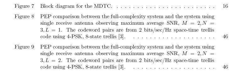

About the figures, I saw some "articles" where the discription of the figures in the list of figures span more than one line. I strictly need to do this, because the requirements is to include the description as it is under the intended figure, like this example:
Regards
