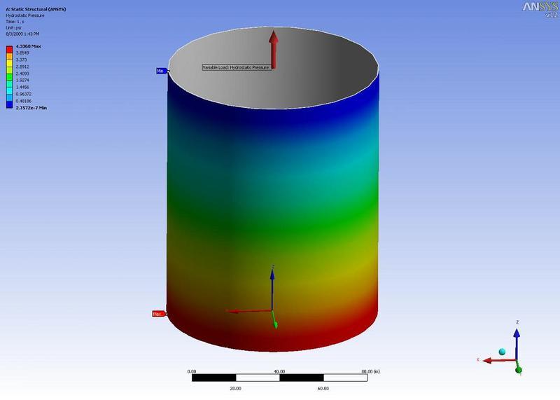

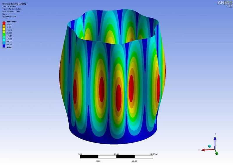

It's going to be difficult to accurately predict the buckling strength of such a structure, mainly due to the fact that it has such a low wall thickness to diameter ratio. Small discrepancies in the circularity of the wall's cross-section (tank ends up elliptically or oval-shaped) can have drastic effects on it's overall buckling strength. Additionally, it can't really be modeled using the submerged pipe codes because it has a relatively short legnth, the hydrostatic load changes drastically along its legnth, and (I'm assuming) it's bottom is fixed to the floor, meaning it it stiffened against buckling on the bottom. I'm not sure there is a quick and dirty analytical solution to this problem.
That being said, a quick linear buckling run through ANSYS with a fixed base and a simple hydrostaic load on the tank's outer wall shows that it's buckling strength is about 12x that of the simple hydrostatic load. But, keep in mind that is for a perfectly circular tank with a perfectly uniform hydrostatic load on it; any non-linearities in the tank or load will drastically reduce it's strength.

For anyone curious, here's the first buckling mode for the tank being discussed. I ran the same model with a 1" out of round (elliptical tank) and it had little to no effect on the predicted buckling failure, which is a good sign (I was thinking it might drop the buckling strength by a significant margin).
As far a buckling and FEA go, a linear buckling analysis is not the most conservative estimate but I don't have time to do a non-linear analysis of the tank. I also didn't do any mesh convergence studies, so I wouldn't take this result as gospel.

I agree that it would be difficult to predict a definitive answer for this type of problem analytically. Hence, I used the API codes to get a conservative answer most of the time. If the situation is critical enough that a more exact answer is needed (due to material or cost or whatever) then it may be worth the extra effort to perform a non-linear FEA.
That being said, we use API 5C3 on a regular bases for our casing and riser collapse resistance calcs and have never had a problem. Of course I do have another specialty program that checks the buckling/stability of the column under dynamic loading conditions. But for collapse resistance 5C3 works well for me. Caveat: I deal with long vertical columns (up to 12,000-ft in height).
Also, regarding ovality, API concluded that although theoretical studies on the effect of tubular collapse resistance consistently indicated that an ovality of 1 to 2 percent can effect a reduction in collapse resistance on the order of 25%, experimental/empirical investigations indicate a much smaller effect. Hence, they do not consider it to be a dominant parameter and do not account for it in their collapse resistance formulas.
