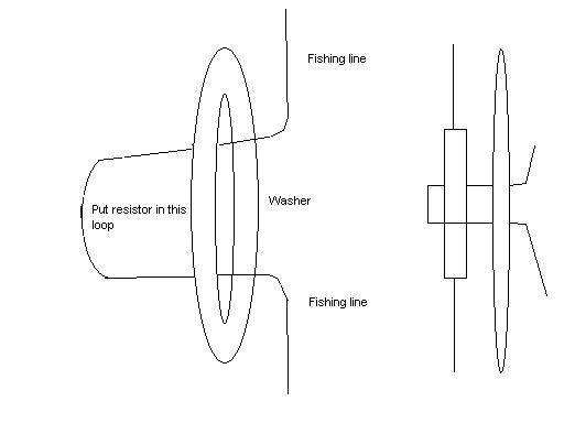

You could anchor the fishing line to a part of the case and then have the Nichrome wrapped around the fishing line but not pulling on it. Apply current and heat up the fishing line to melt it.
Yea, I have found some local shops here in germany and I will order them soon.
And that is my concern now that if I only hook it up to nichrome wire then it might get cut. So I'm planing to pass it through 2 hooks and wrap the nichrome wire around it. I can use a washer like thing, but I am unable to visualize what you previously said about that.
May be you can elaborate that a bit more.
I have attached a drawing of the scheme I suggested earlier.
A fishing line is under tension and a loop of it is passed through a washer or even a smooth ring as used for fishing. The resistor is held in the loop by the tension of the fishing line.
Actually, I should have made the resistor a bit longer so it couldn't get pulled through the hole in the washer. Anyway you get the idea.
When the resistor gets hot enough to melt the fishing line, the loop breaks and the ends of the fishing line can move apart.
If you are tying fishing line to a ring with knots, be careful that the end going to the antenna does not have a ring on it after it melts or this could get caught on something.

Thanks for the descriptive explanation :)
