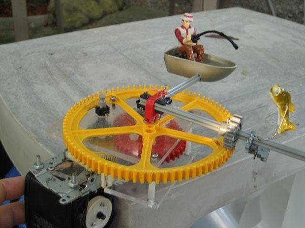

Here it is:
Wow... neat design. So the boat goes around, and the fish goes around in front of it but also leaps into and out of the water?
I still can't see quite how the motor works, but I love the concept of what you're doing. I'm a bit confused by your gearing; it looks to me as if the fish is jumping backward. :confused:
edit: Wouldn't it be lighter, though, and thus require less torque, to mount the models on thin spring wire rather than the plastic rods that you're using? (Yes, I realize that your secondary gearing for the fish will need an axle larger than a wire, but it could be truncated.)
Yeah!

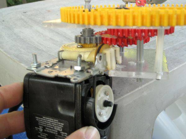

Danger said:
I still can't see quite how the motor works...
What do you mean?
Can can juuuust see a bit of the impellor (yellow bit inside motor casing, behind belt).
The pulley is affixed to the impellor with screws (2 silver lumps on pulley).
Motor pulley drives top pulley via belt. (You can barely see the top pulley behind its mount.)
Top pulley drives worm gear on same axle.
Worm gear drives large horizontal white gear which is affixed to grey gear.
etc.
It may be hard to see in the pic. Fish is facinbg toward camera, we are looking down its maw. It will move clockwise around the yellow gear, just like the fisherman does.
Fish is currently coming up from behind its axle, and will come toward and down in front of the axle.
