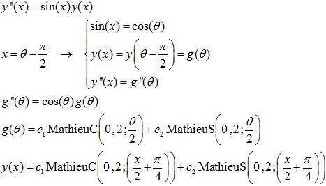

I'm afraid that sin(x) ruins the integration, and as such you're missing a term ##-\int dx y(x) \cos(x)##. After multiplying by 2y' you get
$$\frac{d}{dx}(y')^2 = \left[\frac{d}{dx}(y^2)\right] \sin(x),$$
which can't be integrated exactly - you get ##(y')^2 = y^2\sin(x) + C - \int dx~y(x) \cos(x)##.
Mute said:
I'm afraid that sin(x) ruins the integration, and as such you're missing a term ##-\int dx y(x) \cos(x)##. .
You are right. My mistake !
Damn ODE !
