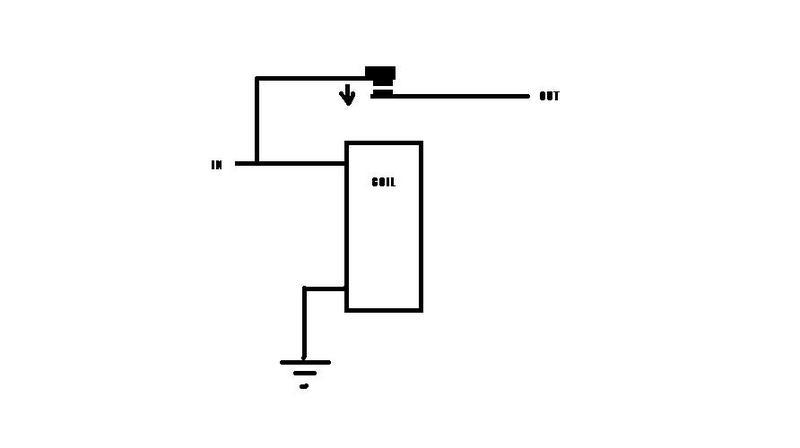

what i want to do is somehow block anything under 10volts from getting to the ballast.
when the daytime running light power is sent to the ballast it causes the headlights to flicker and this will blow the bulbs or ballast quickly.
would adding in a resistor on the positive wire block the power to the ballast if it is less than 10volts?
i am basically attempting to disable the daytime running lights feature.
thank you
You could have a relay that pulled in on more than 10 volts and connected power to the headlights.
If it didn't pull in, no power.
The contacts on the relay would be carrying the full current of the headlights, so it would need to be a good quality one.
It would still draw some coil current during normal running, but this would still be less than running the lights, even at reduced voltage.

with the relay, is there something to drain the unneeded power? i could in theroy add a small light bulb to draw off any unneeded power and it would be ok if i had to...
i understand this but I am not sure how it will all line up...
i just found this...can someonene do dome sort or sketch of what the lines would look like...also if it would work.

is there a power drain on this?
i have heard of a harness that just boosts the signal to the balasts, w had that on the car and blew 2 ballasts in 1 week...it was a home made one and i think the guy cheaped out on the parts because i looked up the design and it looked correct...but sloppy.
im trying to clean up someone elses mess at the same time as findig a solution.
thanks for your reply, greatly appreciated.
Yes, a small current for the relay. Maybe 1 amp when the headlights are on and about 3/4 Amp when they are off. Depends on the relay.
The daytime lights would have taken a lot more than this when they were working.
with the relay, is there something to drain the unneeded power? i could in theroy *** a small light bulb to draw off any unneeded power and it would be ok if i had to...
You don't need to get rid of unwanted power. The alternator of the car will be a little easier to drive, so the car will use slightly less gasoline.
