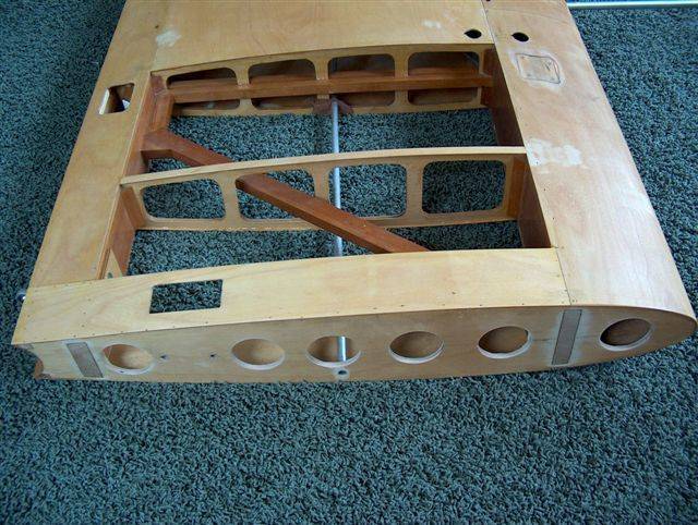

Well on that website there is no way to reach the forum moderater. I am currently suspended and with no way to reach anyone I do not now how long it will last. Other people probably have not had the same problems yet. Reason being the wing kit has not been out for even 2 years yet. For someone to complete an entire aircraft in a 6 month period they would have to be a proffesional builder like myself. I use all the latest equipment. I have a laser dyn I purchased from P&W as well as a few turning centers. I made jigs for this aircraft as I have done with all the aircraft I have built. Usually I can cut standard build time in half. I buy as much of the components pre made as far as fittings, hardware, linkage, and what not. I also work 12 hrs a day seven days a week. I highly doubt anyone has reached the point of completion and test flying. As well as 45 hrs of just acro flight. I know fatigue can also be ruled out. I spoke to steens engineer as well. He said the problem lies in the rear spar. I have thought about that as well and I also believe that is the problem. The rear spar is not attached to the fueselage. Only the forward spar is. Which means that there has to be some sort of cross bracing in the open boxed areas of the wing. The only part there is the plywood wing walk which only extends out two stations. The other thing that really leads me to believe this to be the problem is when I was on the biplane forum sight a response was written to me well lokk at so and so's wings who flies unlimited acro in competition. His wings have held up. Well I looked at pictures of these wings and they actually had steel cables taught between each station, and they had added all kinds of extra pieces. I just want to provide a legitamite load breakdown to show in scientific engineering nature that these wings will fail so the FAA will act on this before fatalities occur.

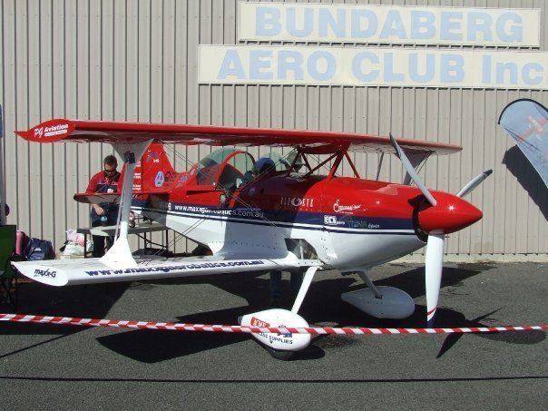

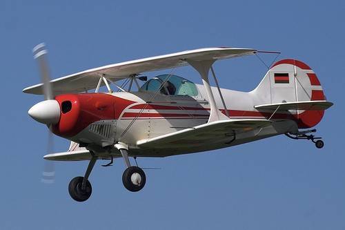

A little visual aid...
http://farm1.static.flickr.com/94/238548991_95c877e9ce.jpg?v=0
Pictures... construction photo's are not the same as the actual kit. That is what these wings need to be safe...The pro's who have been breaking airplanes doing acro know this from experience. The general public however does not. I know a lot about building aircraft but I do not know about structural design. G-force is hard to calculate without an engineering degree. The FAA always encourages not to vary from blueprints. The normal aircraft builder does not seek the advice of an aeronautical engineer about engineered blueprints signed off by the FAA.

I hear you, pitts. However, even for a small plane like the Pitts, reverse engineering the wings would take hundreds, if not thousands of hours. Blueprints would be a big help, of course, but it would still take taken a great deal of time.
To compound this, determining current structural integrity given the problems you mention would be almost impossible to accomplish computationally.
The more appropriate approach is document the issue with clean, sharp pictures and well-written documentation, before sending a package with a good cover letter to the FAA.
