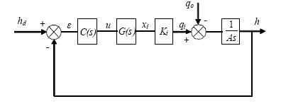

I am given a block diagram (attached below) with 2 inputs (one being disturbance) and I need to find the closed-loop transfer function. I can get the closed-loop transfer function just fine for a normal 1 input system, but I have yet come across one with 2 inputs. I need the closed loop-transfer function because I need to model this system to study the effects of a delay.
List of Variables
Kp, Ti, s, Ki, A
C(s) = Kp*((1+Tis)/(Tis))
G(s) = 50/(1+0.2s)
I know that to get the output, I simply;
  1. equate one of the input as 0 and find the closed-loop transfer function
  2. repeat the same step for the other input
  3. add the two closed loop transfer function together to get the output
However, I end up with
h = ...*(hd) + ...*(qo)
How am I supposed to get it in the form output/input?
Thank you very much for your time and help

After working on this for the past hour, I found this website to reitterate what I thought would be the way to find the closed-loop transfer function.
http://www.atp.ruhr-uni-bochum.de/rt1/syscontrol/node51.html#fig:5.1.2"
However, I am once again finding myself struggling to understand where they went after they get it in the form
output = ...*(input1) + ...*(input2)
From their reasoning, they say that
b)
Disturbances should be rejected or they must have a small influence on the controlled variable .
c)
The controlled variable should track the command input as precisely and as fast as possible.
and hence made disturbance 0. Can I use this principle as well or is this only specific to the example shown?
