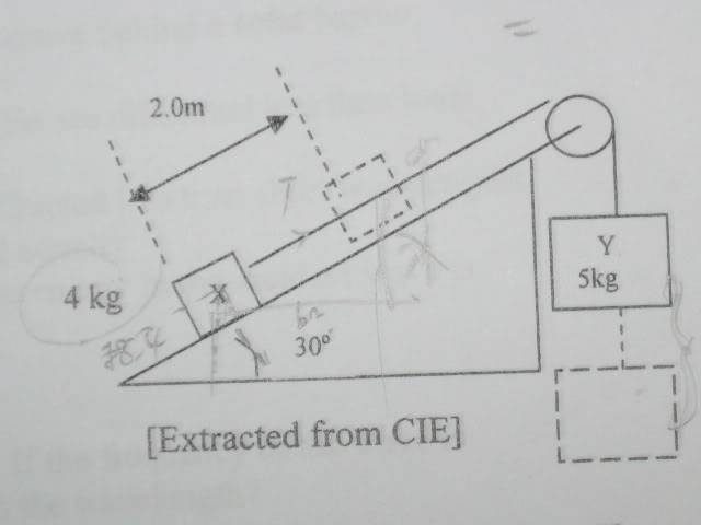

the diagram shows two bodies X and Y connected by a light cord passing over a light, free-running pulley. X starts from rest and moves on a smooth plane inclined at 30 degrees to the horizontal.
What will be the total kinetic energy of the system when X has traveled 2.0m along the plane?(g=9.8m/s2)
E=mgh
my teacher ask me to find the perpendicular distance of y and x, then use formula E=mgh to find the differences between potential energy between X and Y, and the differences will equal to the total kinetic energy since energy is conserved during the whole motion
BUT, i can't even find the perpendicular distance of X and Y

Hi look416! :smile:
When Y moves down vertically 1 m, how much higher does X get? :wink:
but in this case does we assume that Y is moving down 1m?
ops, i think i have found the height of y,
but i still couldn't find the perpendicular height of x

Do you mean "vertical"? (But height is vertical anyway)
The height of x is the length along the slope, multiplied by the sine of the angle, isn't it?
What's worrying you about that?​
