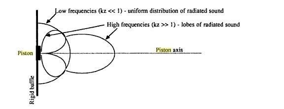

The exact solution for an oscillating piston mounted in a rigid baffle is given by:
[tex] p'(r,\theta,t) = \frac{ik\rho_0 c \pi z^2 U_p e^{i(\omega t - kr)}}{2\pi r} \left[ \frac{2J_1 (kz\sin\theta)}{kz\sin\theta}\right][/tex]
Where k is the wave number, c is speed of sound, z is the radius of the piston, U is the maximum piston velocity.
As you can see, this breaks down at small radii so if only valid for the far-field.

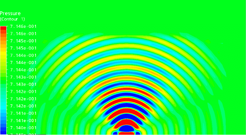

I don't have a lot of good looking plots right now, but here is a plot for a piston period of 16. In this case, everything has been nondimensionalized such that c = 1.0. T = 16 gives a reduced wave number kz ~ 3.9, which is just past the first root in the equation:
[tex] f = \frac{2J_1 (kz\sin\theta)}{kz\sin\theta}[/tex]
That term in the solution gives a directivity and "lobe" relationship. At high frequencies, above kz~3.8 there will be a "lobe" in the solution which theoretically there is no pressure pertubation. As the Bessel functions keeps passing the axis, this number of lobes increases.
It's apparent when looking at the FFT results, which aren't done yet. In fact, I just went on to look at the results and realized that the disk was full and the first run was pretty much completely wasted.

Unfortunately the OP is looking for the near field for sure. That is one of the things that makes this one really tough. The other part about the square ducting doesn't help. The directivity can be tracked down to the relationship of wave number and piston radius. Very low kz, i.e. kz<<1, will produce a symmetrical pattern. Higher kz>1 will go from a double lobed to a single lobed form.
