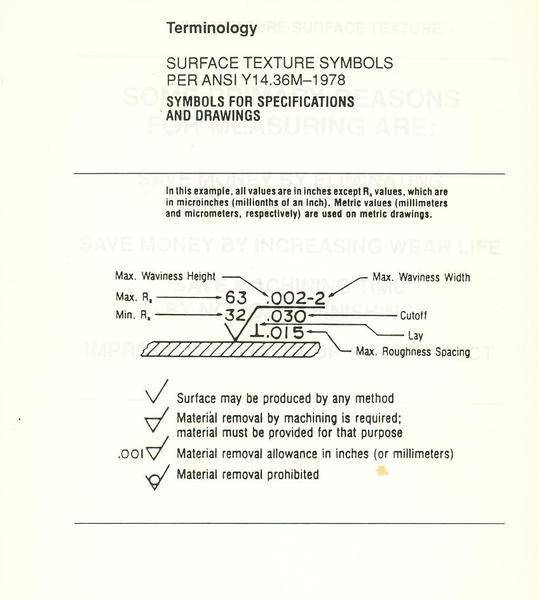

http://img.photobucket.com/albums/v309/Andreii/trrr.jpg" ?
Also, why are some of Ra's http://img.photobucket.com/albums/v309/Andreii/raji.jpg" on the separated part of the drawing (in the top right corner) - some of them are also in brackets, why?

HAving been product manager for a company that made surface texture measurement instruments, the call out is not to ANSI B46 specs...see attached
when only one call out is on top of the check mark symbol it says the Ra should not exceed this amount...any call out inside the Divisor sign is the cut off length or assessment length

Ranger Mike did you relay, in your reply, on the Ra's that are located in the right top corner of the drawing (its part is showed in my first post)? Because from your reply and file that you attached I think we didn't understand each other. You were trying to say what each symbol for roughness means. I already know this, was just interested to know why are some of them separated and why are some of separated ones inside the brackets. It might be logical, as Fred said, if, on specific surface, isn't the symbol for roughness given then it means the symbol(s) in the top right corner is/are valid but why are some of them in brackets then?

About the Ra's in the top right corner: Same as you said Fred. The one before the bracket means that roughness is for the surfaces where aren't other ones stated. The ones in brackets don't have a special meaning but only as a collection of different roughness that are already stated on the drawing.
