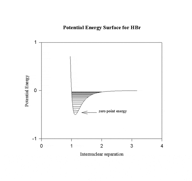

Having discrete, allowed energies is also a property of the two-atom potential we have been discussing, as long as the energy is low enough that the atoms are bound together. That is what is depicted by the energy curve here:
The curved line is the potential energy, while the horizontal lines are the allowed energies for the two atoms. Note, a horizontal line gives the Total Energy (kinetic + potential).
In other words, at any time the total energy must be one of those values given by one of the horizontal lines, and can't be anything lying in between them.
Are you with this so far?
Okay. Bound together means the total energy of the system is below the horizontal "zero potential" line.
Given that the total energy is such and such, I suppose I could figure out how much potential energy it has got from analyzing the curve and thereby calculate the kinetic energy. I suppose these two quantities will characterize the system as all I can imagine in the case of two atoms is only linear motion.
What determines the spacing between two horizontal lines? I suppose that depends on the two atoms/ molecs in question? That should be important, as you say that is what they measure (post #18). Does the spacing between the lines tell you the shape of the curve also?
Yes.
We're getting a little off track here. Are you aware of Heisenberg's Uncertainty Principle ? Suffice to say, we can never measure both the atoms' separation and velocities to sufficient accuracy. So forget any thoughts you might have about subtracting the kinetic (depends on velocity, that we can't know accurately) energy from the total energy to find the potential energy at a specific location (which we also cannot know with good precision.)
The spacing is determined by the solution of the Schrödinger Equation for the potential curve. If you're not too familiar with the Schrödinger Equation, I'll just say that it is a differential equation whose solution gives the allowed (total) energies, and leave it at that for now. So it would tell us the values of the horizontal lines in the graph, and more specifically the spacings between those lines. It is the spacings, or energy differences, that get measured in the lab.
That is the tricky part. Since we don't know the shape of the curve to begin with, we can't solve the Schrödinger Equation (SE) for the curve to calculate the energies. Instead, the energy spacings would be measured as a starting point, and we must do the reverse of solving the SE, to find out the shape of the potential energy curve.
But I think there is more than one possible curve that could produce a given set of energies. (Can anybody else confirm/refute this?). If so, we would need some other information. I am supposing that, since the 1/r6 long-range part of the curve is justified on theoretical (and perhaps experimental as well?) grounds, one might determine what can be added to a 1/r6 potential to fit the measured energy spacings. But here we are getting outside of what I, personally, know about how these curves are determined.
