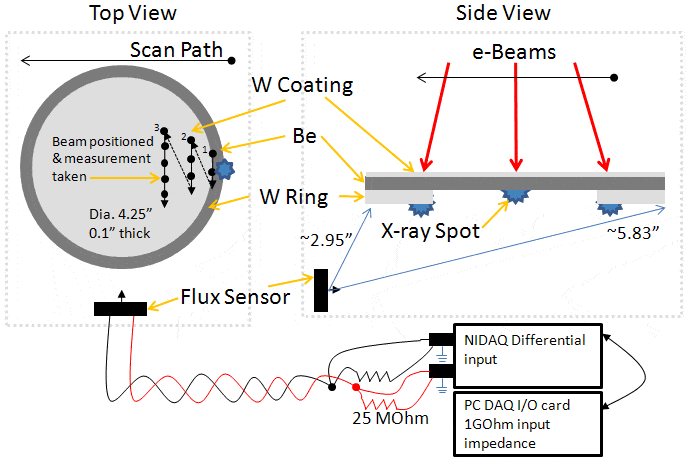

Hi,
Hopefully I'm posting this in the correct forum.
I'm using Nuclear Associates 07-451 flux detector with a gigaohm input impedance such that the measurement read is logarithmically compressed. The x-ray tube is outputting a constant number of rads. The flux sensor is mounted to the left side of tube (not directly below the output window). The x-ray beam is deflected such that it starts farthest away from the sensor and is progressively brought closer to the sensor. The beam is passing through different thicknesses of metal along the path that it travels and a reading is taken at known distances from the sensor (the metal is between the tube and the sensor).
So I know that my measurement is logarithmically compressed and x-ray falloff is 1/(distance^2). Maybe I'm just having a bad day but my Math is not so great to understand how to undo the loss in the signal to compensate for the distance between the beam on the output side of the metal and the sensor, the distances are known by Pythagorean theorem (for the moment I just need to correct this part of the measurement). This part should be easy. Also I'm not clear how to undo the logarithmic compression of the measurement due to the input impedance (mathematically).
Once I correct the measurement then I'm hoping to compensate for the 4.5 million measurements that I have to take before plotting them.
Hopefully this makes sense and I got the right forum.
Appreciate any assistance.
Thanks,
Jeremy

2) I don't understand the geometry and in particular why the distance between x-ray tube and sensor is changing.
3) How do you deflect an uncharged x-ray beam?

2) The distance is changing because the beam is deflected to a point starting 7" (7 inches) from the detector, the beam is slowly deflected to 2" from the detector.
3) We are deflecting the beam with a current deflection coil before it hits the Beryllium window. We can deflect the beam 5" this way (+/- 2.5" from the center) on our large window. I'm not a Physicist to know much of the details about this.

I've attached a rough layout of the system and some of the relevant dimensions, however I can't go deeper than this. If it is appropriate I'll wire the sensor up correctly so that I don't need the differential input (the NIDAQ BNC-2090/PCI-MIO-16XE-50 can be switched to single-ended mode). I forget what the thickness of the Tungsten (W) ring is, at least 0.125". In the present set up I usually measure about 30mV (x-ray off) to 100mV from the sensor (in this less than ideal configuration). Each time I deflect the beam I take a measurement, I scan the entire target this way in small steps.

First, let’s address the physical setup. As you may not know, at non-relativistic energies, the bremsstrahlung + x-ray flux peaks at an angle to the direction of the beam, and classically, the intensity is distributed around the beam direction with a pattern that looks something like a doughnut. At intermediate energies, the “rabbit ears” fold forward, such that the opening angle between the radiation maximum and the electron beam direction is about θ =[STRIKE] E/mc2[/STRIKE] mc2/E, where E is the electron beam energy and mc2 is the electron mass (510 KeV). As the beam is sweeping, this angle, as well as the distance from the radiation source to the sensor, is changing. So modeling the radiation at the sensor as a function of beam position will be difficult. If you want to research this more, see the GEANT4 equation for bremsstrahlung angular distribution in
http://geant4.cern.ch/G4UsersDocuments/UsersGuides/PhysicsReferenceManual/html/node60.html
based on the Koch and Motz formulas.
Next, what is the peak radiation level (rads/sec) and what radiation intensity variation do you expect during the beam sweeps. You need to start thinking about
a) two sensors, one on each side,
b) Is the radiation field high enough to use gas ionization chambers?
c) a single range, high dynamic range current transimpedance amplifier-digitizer (how fast do you need to digitize?). If your sensor goes directly into a NIDAQ with a 10-volt full scale, you need a preamp. if your max sensor current is 100 nanoamps for example, the transimpedance amplifier gain should be ~ 100 megohms.
Before we go any further, what is the maximum rad dose rate, what is the max radiation intensity variation, and what is the max current from your sensor? I am guessing from your 30 mV to 100 mV numbers and the diode equation that the sensor current range might be from 1 to 100 nanoamps, with a dynamic range of ~e3.3 = 30:1. Is that correct? What bandwidth do you need?
Bob S
