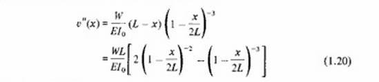

Hi,
Thanks for taking the time to look at my problem.
I'm following a worked example in a textbook and I have come to a line of simplification which I just can't see how/what they've done? I've attached a .jpg showing the two lines of simplification.
Making this simplification helps with integration later on but that's not relevant to this...
Any help would be much appreciated!
Thanks
Simon

[tex](L-x)=L\left(1-\frac{x}{L}\right)=L\left(2-\frac{x}{L}-1\right)=L\left(2\left(1-\frac{x}{2L}\right)-1\right)[/tex]

Brilliant... Thank you very much indeed, I'd spent all day banging my head on the desk over this. I kept trying to expand everything out and group back together again which was pretty stupid I guess...
Thank you again for your help
