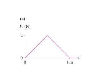

The figure shows the force Fx exerted on a particle that moves along the x-axis. Draw a graph of the particle's potential energy as a function of position x from 0m to 1.1m. Let U be zero at x=0m.
W = F*d
U = mgh
I'm pretty confused about how to start this problem. How do you know what equation to use in this situation?
My best idea is to use W = F*d because it includes both Force and Displacement, and relates them with Work, which is equal to the change in Energy of the system. However, I don't know how to use this to find the Potential Energy at a given Position. Please help!
You need the general relationship between potential energy and force.
U=mgh is just a special case and it has nothing to do with this problem.
Have you seen the relation [tex]F = - \frac{dU}{dr}[/tex] before?
If not, you probably have to review your textbook or lecture notes.
W = F.d only holds true for a constant force, which it clearly is not in this case.

Using the equation F = -dU/dr we can solve for dU:
dU = -Fdr
And then plug in the values for force (F) and displacement (dr). However, what do I plug in for the displacement? For example, at x=0.5
dU = -(2)(0.5) = -1
Is this correct? I'm not sure I'm using the displacement correctly. Also, once I find dU, how do I find U? Do I just take a small interval? Thank you for your help.
In order to find U you need to integrate the force over the position.
You can find F(x) from the graph (separately for the two sections) and then integrate, again for the two sections.

Thanks for all your help, I solved the problem. The reason for my confusion was because I never learned to integrate. I was doing the problem backwards.
