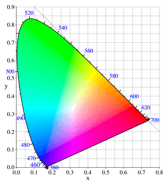

I'm trying to get a better understanding of color and visible light in general and see how every single visible color is formed. Does this sound right?
The sun sends us white light which is a mixture of all the monochromatic colors that our eyes are sensitive to and when we mix both sides of the monochromatic spectrum, we get the extra spectral purples. We can then mix all of the monochromatic colors/extra spectral purples with with white to create less saturated colors. And Black is simply what we see when there is no light present at all. Does this explain how every single color is made? What about mixing the monochromatic colors/extra spectral purples with different grays or even black?

"extra spectral purples" is the general term for any mixed color, ie not on the edge of the CIE diagram

So does the chromatic color spectrum plus the extra spectral purples make up every fully saturated color that the human eye can see? Why are all of these colors mixed with white such as in the CIE diagram?
Roughly the X and Y are the responses of the two types of color sensor cells in your eye (there are really three but two are very similar)
So if 40% of X cells triggered and 60% of the Y you just lookup the corresponding coordinate (0.4,0.6) on the chart and see that you are looking at green-yellow
The colors around the edge of the diagram are pure monochromatic colors from the sun.
The white patch in the middle of the diagram is roughly where the eye is most senstive and the sun's output is highest (because we evolved to be sensitive to this).
To get a real color you also have to take brightness into account, so some colors will look different under different lighting, this is how you get colors like brown.
So if every single color or chromaticity formed by taking the chromatic colors plus the extra spectral colors and then mixing each of them with white?
Isn't that what the CIE diagram is doing?
