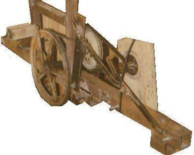

You want cheap? You GOT cheap!
ambuj123 said:
...well if someone could advice some cheap alternative power source i could develop to power fan and tube light it wil be very nice.
Ahight.
Below is a photo of a human powered electric generator. I took the liberty of whiting out much of the photo so as to make the important pieces stand out better. This contraption can output over 10A into a 12V battery, but you will need strong legs if you are to maintain that level. More realistically would be a figure of approximately half that, or even less.
Central to all this is that virtually every component was scrounged. If you really want to dabble with alternate power sources it helps to be a good scrounger and fabricator. For the inexperienced, allow me to detail most of the components you’re viewing; the large pulley was from a broken cement mixer, and the bearing it is welded to (difficult to see it, but a vital component here) came from a tractor’s water pump that had begun to leak around the seal (but still plenty good for this purpose). The middle pulleys are from a junk automobile engine and a small engine (they are welded together). The small pulley on the PM motor was special (Drilled ½” through some metal stock, drilled and tapped for an Allen head screw, then put on the motor itself, secured in a vice, powered on and cut the belt channel). The motor has been secured in a piece of 2x6. The pedals are 2x4, greased to spin on ½” bolts. Much use of bolts was used, both for spinning things on as well as for securing brackets. Note the two identical brackets used to hold tension on one of the belts (it was a quick fix for shortage of material, haha). Adjustable seat height was another feature of this rig.
Well, hopefully this might serve as inspiration for your own creation by showing that a little imagination can often go a long way.
