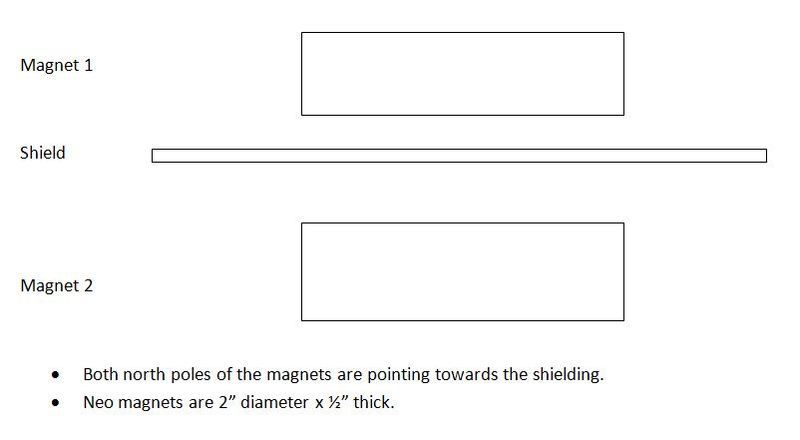

Hi guys
I have a simple question.
The attached picture shows 2 Neo magnets with some Mumetal sheilding between the magnets. Let's say the gap between the shield and the magnets is 2mm. So the overall distance between the magnets is 4mm.
will the magnets still repel from the shielding? If so will this force be the same as if the shielding wasnt there?
Gareth

Yes, in this configuration they should still repel. You put your "shield" at a nodal plane (where the field is everywhere zero) so it has no effect whatsoever.
Ok I read something like that on a site, but didnt fully understand it. Is there material that would stop the interaction between the magnets and not replel the magnets.
Or is there a way of neutralizing the magnets say for 1 second? could this be done with an electrical current?

Wait wait wait! I'm afraid almost everything contained in Neo_Anderson's posts is incorrect. Here are some of the wrongest:
1) Of course mu-metal is magnetic. A magnet will stick to it quite nicely.
2) It reaches high permeability only under very specific conditions at low fields. How did N_A get 400k, by the way? He just made this up.
3) Mu-metal is not a good choice to shield strong fields because it saturates at low applied fields. Paradoxically, iron or low-carbon ("mild") steel is a better choice for intense fields.
4) Finding thick mu-metal is expensive. It is usually available as foils and thin sheets. By the way, it needs special annealing and heat treatment in a hydrogen atmosphere for full efficiency, so machining and forming is usually done prior to this processing. Even the act of cutting a finished sheet with a shears will partially degrade its shielding properties.
5) Placing a shield between the magnets as you have drawn will be ineffective. The magnetic field on the plane halfway between your magnets is already zero.
In the midplane between the two magnets, the axial field is zero. But the radial field in the shield from the two magnets adds, and is very large. Mumetal is a very good magnetic shielding in certain applications where very low fields (< 1 Gauss) are required, but mumetal saturates at about 0.2 to 0.4 Tesla, while soft iron saturates at about 1.4 Tesla, so soft iron is the better choice in this application. The magnetic field from each magnet pole enters normally (along the axis) into the soft iron (remember Bnormal is continuous), travels outwards in the iron radially about 2”, and exits. This means that the total soft iron cross section should be about equal to about half the combined area A of the two magnets at the magnet radius: So
A = 2*pi*R*t where t is the thickness of the soft iron and R is the magnet radius. So we get for t (for R=1.5"):
t = A/(2*pi*R) = pi*R2/(2*pi*R) = R/2 = 0.75”
This will keep the peak radial field everywhere in the iron below 1 Tesla. When the soft iron shield is pulled out or pushed in, eddy currents in the soft iron will resist the force.

Two items:
1) Magnetic forces from PM magnets are conservative forces, meaning that a closed-loop path integral of ∫F·dξ over a path (or series of actions) where F is a force and is a displacement, will not lead to any excess useful energy. The loop integral is zero. Perpetual motion as a source of energy is simply not true. More likely is loss of useful energy due to eddy current heating.
2) The stored magnetic energy in the system is the volume integral
W = [1/2]∫B·H dV = [1/2μμ0]∫B2 dVvolume
where μ is the relative permeability which = 1 everywhere except inside magnetic materials, such as the soft iron shield. When the soft iron shield is inserted, the total stored magnetic energy in the system decreases due to the B field inside the soft iron ( μ ≈2500).
The change in the stored magnetic energy W is directly related to a force:
dW/dx = Fx
So as the soft iron shield is inserted, it is pulled in by this force. If only one magnet is present, the force is halved. If both magnets are present when the soft iron is removed, the force (work required) to pull it out is doubled.
If the magnetic shield were a Type I superconductor that excluded all magnetic fields (Meissner effect), work will be required to push the shield in (because the stored energy W increases), and useful work could be recovered when the shield is removed.
Bob S

I must apologize to marcusl, to gareth01422, and to the forum.
After reading this last night, I took a neo magnet/mu-metal sub-assembly I pulled from a harddrive and removed the magnet. And found that mu-metal is indeed a magnetic material, contrary to what I stated in my earlier posting. "Who in their right mind would consider nickel a magnetic material," I thought, "In light of the fact that a 5-cent nickel does not adhere at all to a magnet; even ones as powerful as neodymium magnets!"
I was incorrect, and did not approach the issue in a scientifically methodological manner. Trying to obtain a magnetic property from a nickel is hardly the Scientific Method! (although I did consider the high copper content in a nickel...)
Marcusl must admit his own shortcoming; that being that mu-metal is quite magnetically permeable even at freq's as high as 100KHz. And, unusually resistant to eddy currents and other factors that govern thermal activity in the alloy. Aside from mu-metal's magnetic culpricicity (it's a word), it functions as a near-ideal magnetic shield!
But gareth's engine can still work, but only temporarily, if he uses mu-metal (or even metglas 2714A) to shield one pole from its like pole.
