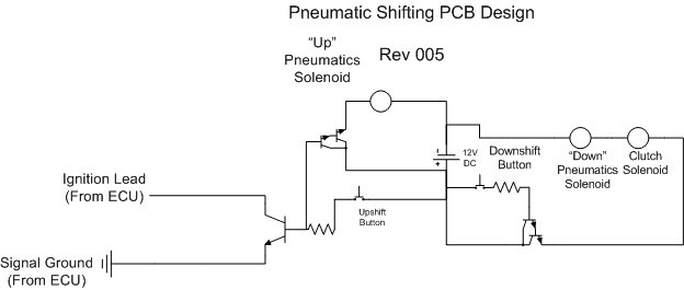

Hey again. I have a circuit that I've made and I was told I should put resistors in so that I don't blow out my transistors and buttons. Ok, I can do that... but I have no idea what size of resistor I need! Picture:
I'm using TIP41C Transistors:
http://www.drixsemi.com/TIP41C.PDF
I think what I needed from this sheet was the "Continuous base current" of 3A?
12V = 3A * R
R = 4ohm?
Does that sound right? Am I oversimplifying it?

What current do these loads draw?
You want the transistors to saturate, which means Vbe > Vce.
Generally, the current gain at saturation is 10 or less.

So you need Ib > 150 mA.
That t'sistor on the right cannot be saturated as it is drawn.
?? why not? What is Ib? The current in b? and why does it have to be > 150mA?

1 because Vbe can never go higher than Vce in this circuit
2 Ib is the current into or out of the base
3 because you want Ic to be at least 1.5A and the current gain at saturation is presumably 10x or less.

I'm thinking that's what was meant by the fact I didn't have enough current gain? After all, I thought about what I needed (higher current in the base), and thought I could use two transistors... then remembered that's exactly what a Darlington pair does :P
I get Ib > .625 mA in this configuration assuming " A typical integrated power device is the 2N6282, which includes a switch-off resistor and has a current gain of 2400 at IC=10A." <--- Wikipedia.

You want to use the NPN transitor as a "low side switch" as shown on the right. The transistor should be fully on (saturated) when the pushbutton closes. Notice the Vce(sat) in the data sheet? That would be the transistor voltage Vce when biased to turn on all the way, so the solenoid would see 12V - Vce.
You may need a flywheel diode to protect the transistor from excess current surge when it turns off (the coil needs to discharge energy and the transistor could get zapped). It would help if you get a spec for the solenoid. I need to consider the bias conditions ...
