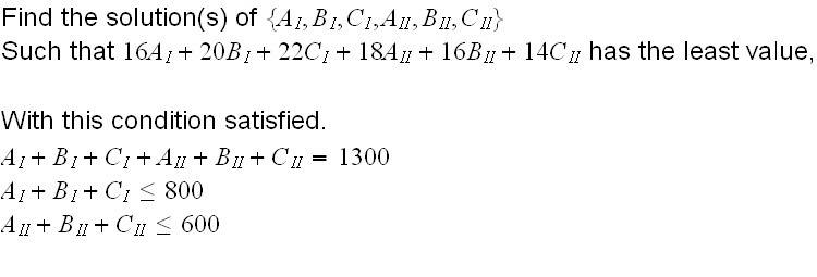

This is no ordinary algebra question.
For the number of units ship from Manufacturer I to Factory A we represent as [tex]A_{I}[/tex] and the rest of other combination will follow the similar notation.

This is indeed a linear programming problem. The main point here is that the total cost of shipping speakers from the two plants to the three warehouses is to be minimized, subject to all of the constraints. icystrike is on the right path except that his first equation should be an inequality. That is, AI + BI + CI + AII + BII + CII [itex]\geq[/itex] 1300.
I'm using the same variable names as icystrike used, where AI represents the number of speakers sent to warehouse A from plant I. The other five variables have similar names.
There should be only one equation - the one for shipping cost. All other relationships are inequalities.

It's easy to see that shipping more than the required minimum to any warehouse can only
increase costs. So the relation can be an equality and you could use it to eliminate one of
the variables.
Icystrike also combined the equations for the 3 warehouses. I can see no reason to do this
If you have AI+AII = 500 and B{SUB]I[/SUB]+BII = 400 and
CI+CII = 400 it implies AI + BI + CI + AII + BII + CII = 1300, but the converse need not be true.
The 3 equations can be used to eliminate 3 variables (but you wouldn't do that if you're going to use the simplex method)
