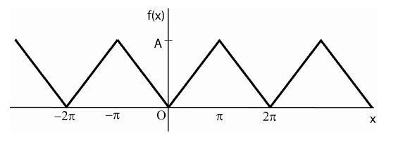

Express the function plotted in the figure below as a Fourier series.
I have the fully worked out solution infront of me and I am ok with working out the a0, an and bn parts but what i want to know is why is the function [tex]\frac{A}{\pi}\left|x\right|[/tex] ?
does the [tex]\frac{A}{\pi}[/tex] part refer to the function between 0 and [tex]\pi[/tex]?
If so what about the function between [tex]\pi[/tex]and[tex]2\pi[/tex]? do i just leave that out? and why is it only integrated below between 0 and pi?
here is the solution:
[tex]f(x)=\frac{A}{\pi}\left|x\right|[/tex] the function is even therefore [tex]{b_n} =0[/tex]
[tex]{a_0}=\frac{2A}{\pi^2}\int^{\pi}_{0}xdx=\frac{2A}{\pi^2}\left[\frac{x^2}{2}\right]^{\pi}_{0}=A[/tex]
[tex]{a_n}=\frac{2A}{\pi^2}\int^{\pi}_{0}xcos(nx)dx=\frac{2A}{n{\pi^2}}\left[xsin(nx)\right]^{\pi}_{0}-\frac{2A}{n{\pi^2}}\int^{\pi}{0}sin(nx)dx[/tex]
...well you get the idea its taking me too long to type out the entire solution so i will leave it at that.
Can someone also please tell me why there is a [tex]\frac{2A}{\pi^2}[/tex] term on the a0 and an terms and why this is not just [tex]\frac{A}{\pi}[/tex]?
In other words where does the extra [tex]\frac{2}{\pi}[/tex] come from? and how will i know when to put it in?
thanks

It looks like the definition of the Fourier integral they are using integrates from -pi to pi. Yes, A|x|/pi is the function on [0,pi]. Since your function is symmetric on [-pi,pi] they just integrated from 0 to pi and doubled it. That's where the 2 comes from. The A/pi comes from f(x). The other pi is in the definition of the Fourier integral. Hence 2A/pi^2.
Ah i see - because the A/pi is just a constant it can come out of the integral, but why is it doubled? why is it not just integrated from 0 - 2pi is there a reason for not integrating between these limits?

Look up the definition of the a_n and b_n's in your problem. In a Fourier series problem you don't integrate between -infinity and +infinity. You integrate over an integral that the given function is periodic over.

Ok i realize that, but why does it have to be normalized? when I've done Fourier series' of other square waves I've never normalized it before and got the right answer

You don't have to normalize anything. That should be already built into the definition of the a_n and b_n's. What are they?

Ok i totally get that now, it was the normalization thing that threw me for a second, Doubling the integral only works for even functions yes?

Sure. It works because you can say 'the negative part equals the positive part'. You can certainly say that about even functions. And probably not many others.
