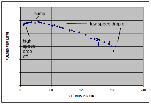

Hi All,
To help things, I've attached a photograph of an example rotor, and the sort of response that can be seen. My mission (which I have decided to accept) is to flatten out the response characteristic i.e. reduce the low speed roll-off, and beware of the high speed roll-off.

The pick-up is optical. So, I'm not too worried about the pick-up slowing down the rotor! (unless we use a 1TW laser, of course!).

- Increasing impeller width flattens the curve
- Decreasing the number of vanes steepens the curve and moves peak efficiency down and to the right
- Milling the blade tips can also flatten the curve
