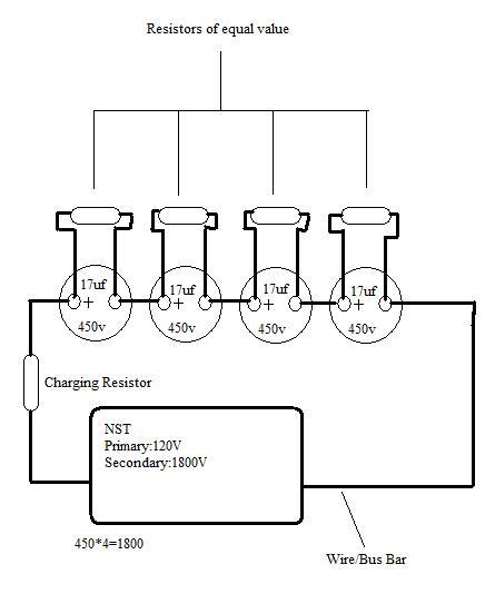

I have 23 450V 1600uf electrolytic capacitors and was wondering if I could use them in a series? If I were to put them in a series, would they act like a single 10,350 volt 72.727 uf capacitor? Or would they melt/fail/leak/explode if I tried to use them that way? Any information is helpful! Thanks!

Would this be correct?

That would do it, except that you've still quoted the Vmax as 1800V for 4 capacitors. Capacitors can vary wildly in actual value and as a result the voltage partioned between them will vary just as wildly. This is especially true of electrolitics.
If you're just making one or only a few of this design, you can determine the voltage each capacitor will obtain simply by charging the string to a lower voltage test voltage--say 30 volts and measure the voltage drop across each. The one with the greatest drop will limit the maximum value you can place across the string.
In your drawing you've placed resistors across each capacitor. But what are their values? Selecting the required value depends upon the leakage current through each capacitor. This is not something easily measured. You're also interested in the leakage current at the maxium temperature in which the capacitors will be operated for your calculations. Capacitors are leakiest when hot. If it's going to get hot you will need a good fudge-factor that will reduce the value of the resistors or test in an oven.
So look up the leakage current in the component datasheet. You will probably get only one value quoted over operating temperature range.
Alternately you can discover the value emperically. Warm them to max operating temperature, place a test voltage across the string of capacitors without the resistors. Measure and write down the voltage across each capacitor. Write down the time power was applied. Wait. Measure the voltage again and write it down. Q=CV. Q=current times seconds. I = CV/t.
We don't really care about the total leakage current, but the maximum difference in leakage between any two capacitors.
One thing you should be aware of, is that the leakage variation becomes balanced by the resistors because some capacitors develop a greater voltage across them than others. This becomes another reduction in the maximum voltage you can apply across the string.
Finally, I don't know right off how large the resistors should be whether you obtain data from measurment or from a datasheet. So if you can come up with leakage data, I could calculat your required resistance values, or supply the relevant equations.
I think you need at least 5 capacitors, btw.

OK. You are making just one thing, and you intend to discharge it almost as soon as it is charged. These are good things to know. It makes things simpler.
Leakage current will overvoltage the strongest capacitor in a series over time. This is so because the leakage from the rest will continue to charge the one that leaks least. This is something that happens over time. Since you want to apparently discharge within a few minutes, it may not be a problem. But it still bothers me. Look up the leakage current for your part numbers in an internet search.
If your capacitors are labeled with a WVDC (it means maximum working voltage maintained at the labeled valued") derate them 50 volts. If they say 450 WVDC don't take them over 400 volts.
Next, your capacitors should inform you of the actual capacitance you can expect for anyone given capacitor. It should say something on the case such as "72 uFards +50%, -10%." What does it say on the case?
