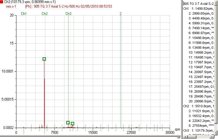

hi guyz,
I have Turbiine(5500RPM)-Gearbox(output 1500RM)-Generator-Exciter-Permanent Magnetiic Generator(PMG).
I have problem with high axial vibration at ball bearing permanent magnetic generator.
Axial vibration at 5500RPM, but it rotate at 1500RPM. This overall is 3-5 times radial direction.
I have confirmed that there is no bearing cocked on shaft.
Is there anyone can help me..?

we have change the bearing both side, and nothing change in amplitude. we always keep it(PMG) runs at 50Hz, so I guess electrical problem due to line frequency(difference air gap between stator and rotor) should come at 6000 RPM (is not the real problem). Because our dominant frequency is 1XRPM highspeed gearbox about 5500RPM read at PMG ball bearing. permanent magnetic generator(PMG) itself rotate at 1500RPM.
and I don't think it could be bent shaft.
can it be a resonance..?or any probable that I miss in thought?

Axial vibration at running frequency is typically angular misalignment between the driving and driven equipment. Measure the phase difference between the gearbox and generator, if they're out of phase you should definitely look for angular misalignment.

first I thought it was a misalignment or bent shaft due to high amplitude at axial direction. but clearly inspect at its spectrum, the dominant frequency is about 5500RPM. at the time condition our PMG surely running at 1500RPM. that's a little weird for me.
for misalignment and bent shaft the dominant frequency should be present at 1500RPM or its harmonic.

You said the turbine was running at 5,500rpm. Seeing vibration at this frequency on the output shaft (although geared down to 1,500rpm) wouldn't be unusual, particularly for a torsional or misalignment issue. Are there helical gears in the gearbox?

Will await an answer to Fred's question, but this could easily be (natural) torsional or linear (vertical/horizontal) vibration from the turbine at running speed (5,500rpm) being translated to axial vibration on the driven equipment by thrust loading through the helical gearbox, and/or by angular misalignment between the turbine and gearbox.
Your relative measurements between the turbine, gearbox and generator will diagnose these theories.

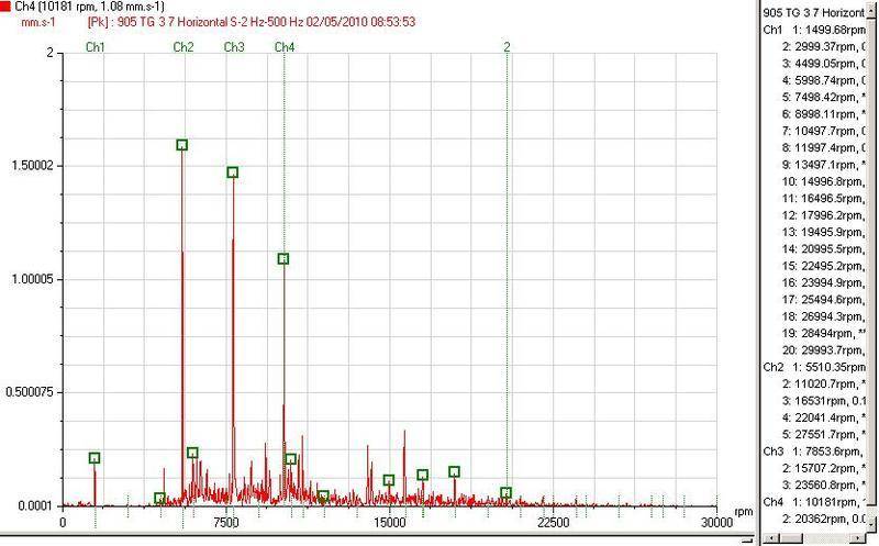

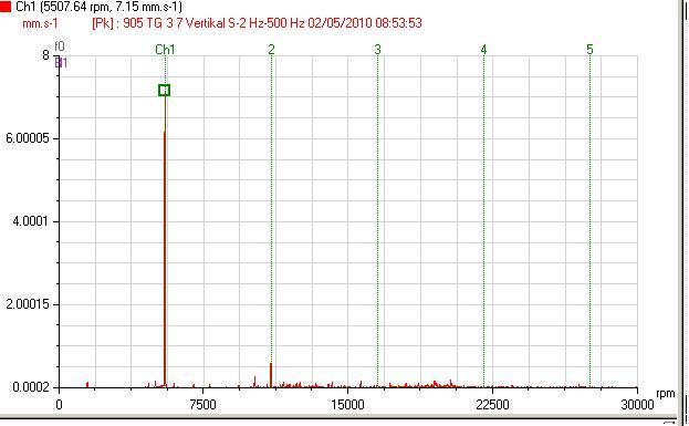

Vibration spectrum at radial(vertical & horizontal), have the same dominant frequencies at 5,500RPM. Both frequencies(5,500RPM and 1,500RPM) have harmonics. Please have a look at 2 files attached.
