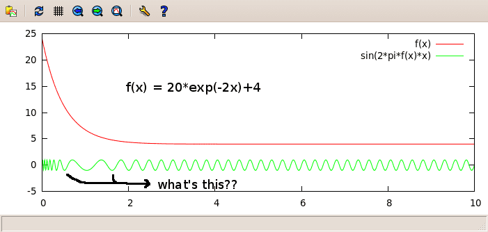

I'm trying to do something very simple...
I'd like to have a sine function, where the frequency is controlled by a separate frequency function
Something like this:
g(t) = sin(2*pi*f(t)*t)
Assume that
f(t) = 20*exp(-2*t)+4
I would expect a sine wave that starts at 24 Hz and then slowly slows down to 4 Hz.
But when I plot it, I get some strange results for t in [0.5, 2], see attached image. The frequency for those values is very low. How's that possible? Is it my plotting program that acts funny? How can I get the expected (described) behaviour?
Thanks in advance!
does your program think that the angle your inputing into your Sin function is in Radians, or degrees?
I haven't done this myself yet but I suspect when you expand from exp to trig form you'll find you have a beat.
20*exp(-2*t) is about 4 around t=0.8.
http://en.wikipedia.org/wiki/Beat_(acoustics )
This is weird. Do you still get this effect if you zoom the plot to 0.5<x<2?
It looks like the software (mathcad?) is correctly interpreting the sine argument as radians, as evidenced by the 4 Hz oscillation for x>2.5.

This does not look like beating, the amplitude stays constant.
Update: I plotted this function in Excel, and get the same plot! I'm looking more closely at this, stay tuned.

Okay, I have figured it out.
Generally, we have
y = sin[θ(t)]​
I.e., the argument of the sine can be thought of as a time-dependent phase angle.
The angular frequency is
ω = dθ/dt​
Differentiate the sine argument in the OP, and one finds
ω 2π f(t)​

What RedBelly was saying is that the extension from constant to varying frequency is not done by multiplication but differentiation.
Just like the differential slope of a curve A(t)*t is not A(t) but [A(t)*t]' (I wrote the function in this form to deliver the point)
The "differential frequency" of a sine wave, is the derivative of its argument rather than the coefficient of t.
Try plotting the function sin(-10*exp(-2t)+4t) and check if it gets you the desired result.

Okay. Suppose we have a spinning object, and we are given it's orientation θ as a function of time, not necessarily a linear function. How would you determine the rotation rate, ω?
I think you need an explanation for why the frequency is lower than 4 in the range 0.5 to 1.5.
You differentiate the sine argument in the OP,
2π*[20*exp(-2*t)+4]*t​
and find that the result is less than 2π*4 rad/s, or 4 Hz, over some range.

When I plot sin(2*pi*(-10*exp(-2t)+4t)), I get exactly what I want/expected.
But... elibj123, how did you get to this: -10*exp(-2t)+4t ?
When I calculate [f(x)*x]' I get something else, namely:
[tex]-40\,x\,{e}^{-2\,x}+20\,{e}^{-2\,x}+4[/tex]
edit: aaah, it is the antiderivative of f(x)! :-)
Ok. I get the phase and phase velocity argument. That makes a lot of sense.
When I take the derivative I find that the min frequency is at t=1 and the phase velocity is ~1.3 which matches the plot very nicely.
