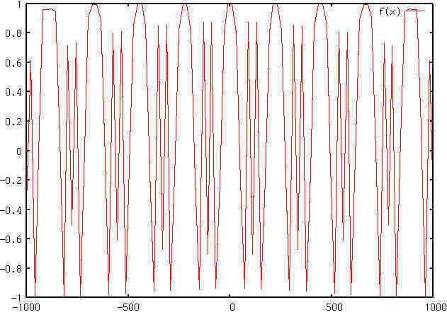

Hi gafar,
i quickly plot your function f(x)=sin(x*x).
between three x ranges [see figures below]
1. between -10 to 10,
2. -100 to 100 and
3. -1000 to 1000.
from that it follows a kind of periodic change. [in general most of the sin functions are periodic]

Rajini said:
Hi gafar,
2. -100 to 100 and
3. -1000 to 1000.
Rajini the function y=sin(x2) doesn't look at all like what you're seeing in those graphs! The fluctuations of 1 period at x=1000 are approx 6x10-3 which is tiny! In other words, the computer (ignoring miscalculations) doesn't have enough pixels to represent the vast number of up-downs of the function so it has given you what you see there.
Aha, i noticed that problem...
I made those plots using gnuplot.
If that function is periodic then the period should be extremely small!
