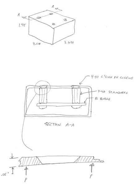

I have an issue I'm not quite sure how to approach. A customer is requesting that we prove that our battery pack chassis will not burst or deform if additional gases are introduced inside the enclosed box (the batteries could vent).
The chassis is assumed to be a sealed .05" thick 5052 AL enclosure with dims shown (attached). There are four countersunk screws attached to standoffs securing a PC board inside. The volume of air in the box is approximately 205.8 mL. If 2400 mL is introduced, how would I find the pressure exerted on the inside walls of the box and, more importantly how do I illustrate that the thinnest portion of the wall (at the countersinks) won't give. Pressure inside and outside the box during installation is 11.777 psi. Thank you.

Couldn't you use the ideal gas law to calculate the pressure? You will need to know the total mass of gas inside your container. As far as the stress concentration around your countersunk holes, I would look through Roark's book to see if anything is listed. As a rough first approximation, you could treat them as circular holes under plane stress. Keep in mind that there will be additional stresses due to the screw/standoff and weight of the board.
