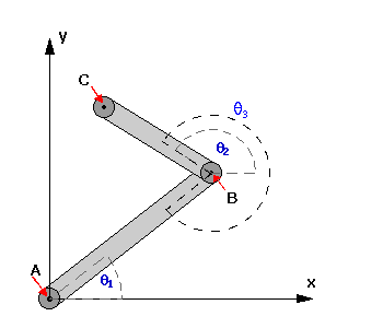

How do u convert relative angle to absolute angles?
The discussion revolves around converting relative angles to absolute angles within a geometric context, specifically focusing on the relationship between angles theta 2 and theta 3 as depicted in a figure.

ie: in the figure theta 3 i got i want theta 2 what formula would i use
help please
I think it's th2=th1+th3-180
There isn't enough information to tell.
It's basic geometry.
Assuming the line I've drawn is parallel to the x axis
th2 = th3 -th
and
th = 180 - th1
Therefore
th2 = th1 + th3 - 180
