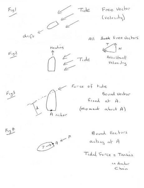

To illustrate consider the ship in the sketches.
Fig 1
Shows a ship drifting freely in the tide. It picks up the velocity of the tide, whcih is a free vector.
Fig2
The ship is now under power and has a heading velocity. This is also a free vector, as is the resultant velocity shown by the vector triangle.
Fig3
Shows what happens as the ship drops anchor at A. It no longer possesses any velocity, but it is subject to a force from the tide. This force has a moment about the anchor point and cause the ship to swing round to Fig 4.
Fig4
The ship is now at equilibrium in between the bound force of the tension in the anchor chain and the tidal force as before.
and yes, Wiki is correct.
