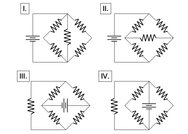

Which of the following circuits could be reduced to a single resistance and a battery by determining the equivalent resistance using combinations of resistors in series and parallel?
A. II and IV only
B. I and II only
C. II and III only
D. I and III only
E. I and IV only
Parallel: 1/Req = 1/R1+1/R2+...
Series: Req= R1+R2+...
I think 3 and 4 can be eliminated because it seems impossible that you can reduce those to just one resistor.
So I'm thinking the answer is I and II only, but I'm unsure.
Take a closer look at 4. Redraw it (hint: it'll have 3 parallel resistor branches).
For 2, are you planning to use the delta to Y transformation?

Don't worry about it then :) It's a transformation that would allow you to change circuit 2 into battery+resistor circuit. Since you said you thought it could be solved, how did you plan on reducing on?
well the resistors on the outer edges of the diamond are in series. You can reduce those to one resistor each. Then you have 3 resistors in parallel which you can reduce...i think
For circuit 2? That wouldn't be correct. Every resistor is connected to nodes (point where 3 or more wires meet) at both of its ends. You can only claim that resistors are in series if they do not have a node inbetween them.
---R1----R2---- Resistors 1 and 2 are in series
---R1---R2---- Resistors 1 and 2 are NOT in series
'''''''''''''R3
That is however the correct approach for circuit 4.
Okay, So I see what your saying. The correct answer would be E. I and IV, unless I've got something wrong out of your explanations...
