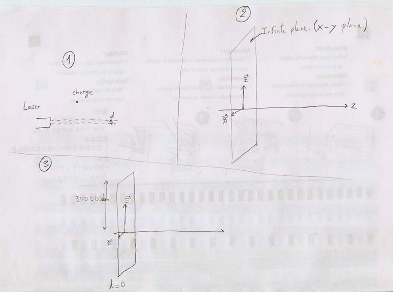

I have scanned some sketches. Part (1) was a doubt I had. That is, if the electric charge will eventually suffer a Lorentz's force due to the laser beam. Now I know that the answer is no. I represented the thickness of the laser beam as d. My question is what is the thickness of a single EM wave?
In (2) I show the infinite plane in which is defined the EM field at a fixed time. My question is: are the E and B field different from 0 for all points in the plane? If not, why do we say that the plane is infinite?
(3) shows the simplified example of my last post. E and B are defined at say a not null distance from the source (I forgot to draw it, it should be over the z-axis at the intersection with the sketched plane) at t=0, the time where the EM wave is emitted.
I'm considering plane waves, not spherical waves.
I hope my doubt is clearer.
All in all I'm asking what is the thickness of an EM plane wave? If it is finite, why do we say the planes where E and B are defined are infinite? Does this mean that E and B can be different from 0 anywhere in the infinite plane? If so... then I can define E and B so far if I divide the distance by the time since the wave has been emitted, I enconter a velocity greater than the one of the speed of light in vacuum. So at least one reply of my questions is no.

Last attempt to explain my doubt
Hey there. I will make a last attempt to explain my doubt.
To start, take the image I uploaded in my previous post. See figure 2.
Since E and B are vector fields of infinite extension, it doesn't matter if we represent them by a single vector centered over the z-axis or anywhere else, as long as the direction and modulus of them doesn't change.
My doubt is whether the E and B fields are defined in all the x-y plane and in case they aren't, why? What equation allow me to determine their extension in space? Is there a discontinuity in the fields if both have a finite extension? What exactly determine their extension?
Let me see if I can explain this well.
Suppose at some instant in time t=0 the spatial shape of the E field is:
[tex]\vec{E}(0,x,y,z)=f(z)\hat x[/tex]
This is your figure 2.
Then the plane wave
[tex]\vec{E}(t,x,y,z)=f(z-ct)\hat x[/tex]
is a valid solution of Maxwell's equations in vacuum for an appropriate choice of B.
However, if the spatial shape at t=0 is given by:
[tex]\vec{E}(0,x,y,z)=u(x)u(y)f(z)\hat x[/tex]
where [tex]u(x) = \left\{ \begin{array}{lr} 1 & : 0<x<300000 \\ 0 & : otherwise \end{array} \right.[/tex]
This is your figure 3.
Then
[tex]\vec{E}(t,x,y,z)=u(x)u(y)f(z-ct)\hat x[/tex]
is not a valid solution of Maxwell's equations in vacuum.

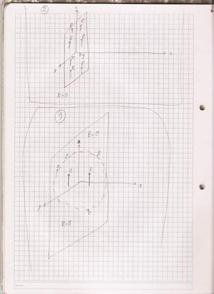

The discontinuity of the electric field in a homogeneous medium is causing the problems. The fields can be discontinuous, but this arises due to boundary conditions where the permittivity and/or permeability are discontinuous across the boundary. So an easy way to look at this is purely from the boundary conditions. The tangential electric field is continuous across a boundary and the normal electric flux density is continuous. If we take say x=0 as an artificial boundary, then \epsilon E_x must be continuous but this cannot happen since you have a discontinous electric field and a homogeneous background.

I was going to reply here but I decided to think more. I'll post a new sketch, my previous one was not very precise.
Ok thank you Born2bwire, this is of great interest.
Hey Dalespam, actually you understood well my sketch from your description, but now to me the sketch doesn't make the sense I intended to put in.
In case your answer (to Dalespam) still holds, please let me know.
Description of the new sketch: Since the EM waves is a EM field, I represent the field as several vectors situated randomly in the field, instead of just 1 vector as usually seen in most books. I also didn't drew the B field which is of course present.
(2)- I represent the x-y plane at a given time. The E field has a constant value different from 0 over the whole plane, i.e. it is infinite in extent. So there's no discontinuity and therefore I'm almost sure such a field satisfies Maxwell's equation.
Sidenote: But I've been told in the early posts of this thread if I remember well, that the E field is not different from 0 in all the plane. Hence my suggestion that it was defined over the whole plane and that there was a discontinuity, passing from a non zero value to 0, but Born2bwire showed me such a field doesn't satisfies Maxwell's equations, so I'm sure such a field cannot exist.
Now I come up with a new idea:
(1)- Same as before: t=0. I drew a circle inside the x-y plane. Inside the circle the E field is absolutely constant. Over the circle the E field decreases quite fast and reaches 0 outside the circle, say by a function of the type of a Gaussian or so. Does such a wave satisfies Maxwell's equations? I see no reason why not.
The circle of the figure (1) is what I call "thickness" of the EM wave. I have never had any comment in the course I'm taking about the spatial representation of an EM wave. I wanted and still want to be able to imagine how is a single EM wave. That's why I started this thread.
Other comment: I first thought that (2) was possible, moreover I though that any ray of light had an infinite extension in the x-y plane, in classical EM. All this because I've read that the planes perpendicular to the axis of propagation of the wave are infinitely large. But any plane is actually infinite, so I thought they mean that the E field had a non zero value in all the plane, which clearly isn't true.
I want to see a mathematical equation that describes how the "borders" of a plane EM wave behave. I drew a circle because it was the most natural to me, but I'm not sure it makes sense.
Also notice that all the equations I've been given in class which satisfy the wave equation give information about the spatial extension on the z-axis (axis of propagation) and never give any information about the spatial extension of the wave in the x-y plane. I realize now that in class we've always assumed that if the value of E over the z-axis at a given time was say 10V/m, then it was so in all the x-y plane perpendicular to the given z. Now I know it's totally wrong and impossible to say so.
Lastly: The modified doubt I still have is the following one: since the E field is defined in a certain non infinite region in the x-y plane, is it so since the EM wave (I'm talking about a single EM wave) was created? What exactly determines the spatial extension in the x-y plane of the EM wave? If it is for example defined as a circle, at what speed was it created? I have a "video" in my mind like this: At t=0, a spherical wave with no spatial extension is created. Moments later it's like a circle in a plane I see from above. Now we only consider say the right part of the wave front. It looks like a plane wave when t increases. In this case the spatial extension when the wave was created (t=0) was 0, unlike what I previously thought.
Sorry if the message is too long or if I'm still not expressing myself well. Please let me know anything you want me to precise. I'm extremely worried about these basics doubt: I can't picture what an EM wave looks like in Classical electromagnetism. When I'll take a QM course I'll understand I can't picture such a wave, but in Classical theory, I think I must understand how to represent such a wave and understand well how it behaves.
Thanks a lot for all.
