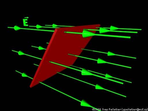

I know that electric flux is defined as the number of electric field lines passing through an area but what kinda area are we talking about. Does it have to be perpendicular to the field lines like this
or could it be at an angle like this
ElectricFlux.jpe
does it have to be a flat area on 1 plane like the previous 2 examples or could it be a 3D area like this
All of your illustrations are perfectly OK examples of an electric flux through a surface.
A flux is defined as a dot product E dot A essentially, so your flux will be reduced if the surface is not perpendicular. Think about it like shining a flashlight at a friend. If you tilt the light away from him, he can still see the light, but it's not as bright. You can just imagine that less flux is reaching him because the light has been moved at an angle relative to his eyes.
Also, it doesn't have to be a nice shape. For example in your last picture, it is not, and in this case, you'd need to use the differential formula for the flux, which involves the integration over the surface. This just takes into account that the flux through different portions of your surface is not constant, and generally you'll need a function for the surface of your shape.

No, they are not. If you want to think in terms of field lines, then the density of field lines gives you a measure of the field at some point. But you won't know the flux until an area is defined. Field is at a point; flux is over an area and depends on the orientation of the area with respect to the field.
