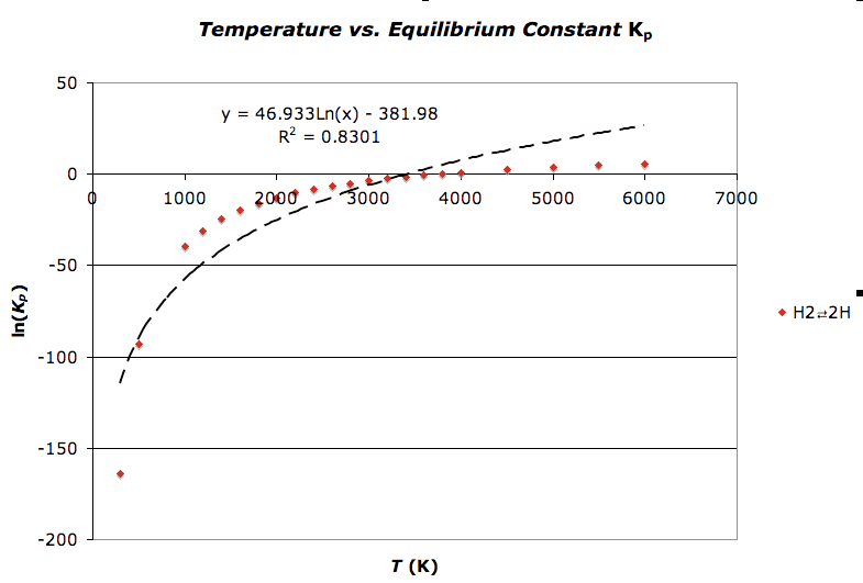

Hey folks,
Am I doing something wrong here? It just seems like I should be able to get a better fit. The data is plotted for the H2-->2H reaction data. I have attached the .xls file. Don't worry, no macros :wink: I created it on a Mac, but hopefully everything converts correctly.
Here's a snapshot:
Am I missing something very simple here? The title on your graph says "Temp versus K" but your axes are actually log(K) versus T.

Are you sure there's a logarithmic dependency in your data set? If there was, then rescaling the x-axis to a log scale should give you a straight-line plot.

I used my company's http://www.miraibio.com/masterplex-readerfit/curve-fitting-for-plate-readers.html" and used the Best Fit feature (and optimized for root mean square error) to find the best model equation and it appears to fit the 4 Parameter Logistic or 4PL surprisingly well:
http://www.miraibio.com/images/curve-saladsamurai.gif
I just realized that your x-axis was not in log scale. Here is the same curve fit with the x-axis on a linear scale.
http://www.miraibio.com/images/curve-saladsamuraiv2.gif
Here are the parameters that were calculated:
A = -1862.64705 (lower asymptote)
B = 1.04715 (Hill slope)
C = 34.42647 (inflection point)
D = 13.67627 (upper asymptote)
R-square = 0.9999544 (although R-square is not really a really good indicator of nonlinear curves I thought I would post it anyway since you have it in your post)
RMSE = 0.28340 (root mean square error is more reliable and it is really good in your case)
Although MasterPlex ReaderFit is intended for ELISA analysis, it's application is flexible which is why I gave it a shot in your case. In all honesty, I was surprised at how nicely the curve fit came out to be (and I am assisting customers all day with curve fitting)!
Anyway, I hope this information helps :smile:
You might consider:
Ln(Kp) = a / (c * Temp + d)^b + Offset
a = -1.4895890519700544E+04
b = 9.6571085998524553E-01
c = 3.3096509207808700E-01
d = -1.4626098473438096E+00
Offset = 1.5342375844418289E+01
as it fits with RMSE of 0.0061 and r-squared of 0.99999997, the fitting page is at:
http://zunzun.com/Equation/2/Miscellaneous/Polytrope%20Transform%20With%20Offset/
It appears to interpolate and extrapolate smoothly and reasonably:
[PLAIN]http://zunzun.com/images/temp1.png
I found this using the http://zunzun.com "Function Finder" at:
http://zunzun.com/FunctionFinder/2/
and turning off the Polyfunctionals as I wanted named equations only.
James Phillips
http://zunzun.com
zunzun@zunzun.com
This function might be better since it has only three coefficients, and the terms are simple functions.
RMSE = 0.0083, R-squared: 0.99999995,
y = a( Temp(K) ) + b( 1/Temp(K) ) + c( ln(Temp(K)) )
a = -2.0624423802678490E-04
b = -5.1874919532864478E+04
c = 1.7768380294902535E+00
James Phillips
http://zunzun.com
zunzun@zunzun.com
