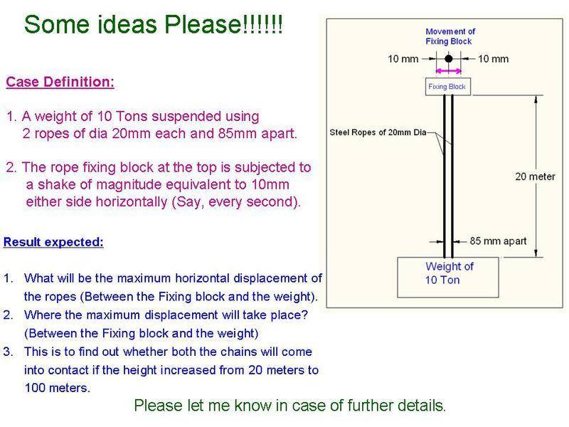

Dear all,
Here is a problem that I need to get an answer. Kindly look at the image attached and help me by solving it.
Many thanks in advance,
Jnanesha KS

You'll need to provide more details about your application, otherwise people will think this is homework, or perhaps some textbook-style problem for independent study.

Ok. I am also a mechanical engineer but lost touch with mechanics/vibrations etc. I work in prodcut design (concepts) enviornment and does not involve in much of calculation except some basic things like stress/shear stress/spring design/gear selection etc.
This piece of work is not either homework or from a textbook.
Kindly let me know what further inputs are required. From overview, I also thought following inputs might be needed:
1. Height of system (height of 10T mass from ground)
2. Friction (can be assumed zero)
3. Linear elongation of ropes (can be assumed zero)
4. System has damper? (from the figure it is un-damped system)
5. Perturbing pivot – every second 10mm to left or right à Is this continuous or for particular duration? (like 1 minute/1 hour etc)
I hope you guys trust me and help me.
Thanks,
Jnanesha KS

What progress have you made calculating the natural frequency of vibration of the system?
The way the rope fixings work will be important in the way the vibration is transmitted to the ropes, both top and bottom.
I would also bear in mind that 20mm thick steel 'ropes' are pretty stiff transversally so will not really start to flex properly until some distance away from top and bottom fixings.
As you have described it, this looks like a theoretical exercise?

What is the own frequency oscillation of the system?(Response to a unit impulse?)
