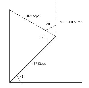

Getting Back. An explorer in the dense jungles of equatorial Africa leaves his hut. He takes 37.0 steps at an angle 45.0 Degrees north of east, then 82.0 steps at an angle 60.0 Degrees north of west, then 52.0 steps due south. Assume his steps all have equal length. Save him from becoming hopelessly lost in the jungle by giving him the displacement, calculated using the method of components, that will return him to his hut.
What the magnitude of the explorer's displacement? 47.6 steps
What the direction of the explorer's displacement? <--- ok for this one, i did arctan(y/x) which is -15.164 but it's the wrong answer. am i doing something incorrectly?
my work:
37cos(45)i +37sin(45)j
-82cos(30)i+82sin(30)j
+ (-55)j
-44.85i+12.16j
arctan (12.16/-44.85) =-15.164 Degrees
can anyone tell me why i am getting the incorrect answer?
Where did the 30 degrees come from? Your problem said "60 degrees N of W".
Man, if you only gave the correct information, you wouldn't be wasting so much time, waiting. You probably also gave the wrong info to the TA.
no i didnt give you guys or the TA the incorrect time, i gave the TA a print out. i took the angle next to the 60 degrees, which is 30. 90-60 = 30 Degrees, i just did the problem differently.is my setup correct? my friend helped me set it up at school, and maybe i just got lucky and got the first answer correctly. is the correct setup? and how would i find the answer to my second question?
i seen other students at the tutoring center set it up this way:
-82cos(60)i+82sin(60)j
+ (-55)j
and they get an incorrect answer when they submit their answer. this is probably the way you guys were thinking. students that set it up my way got the correct answer to the first question, so i don't know...
It's certainly true that 90-60 = 30, but so what? If you want the x-component of a displacement you'd better be using [itex]cos\theta[/itex], where [itex]\theta[/itex] is the angle from the x-axis. That angle is 60 degrees, not 30. (Your diagram is not draw to scale.)
+ (-55)j
This is the correct way to find the displacement of the explorer from the starting point. To find the displacement that will return him to the camp, take the negative of that sum.

Correction: 52, not 55
+ (-55)j
That last piece should be 52 steps, not 55. You'll have to redo the sum.
