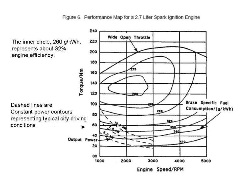

I agree with Russ. The internal combustion engine is most efficient at ~35% of redline and 80% of maximum torque, as shown in BSFC (brake specific fuel consumption). See thumbnail. For lower power requirements, the engine RPM should be reduced by staying in the highest gear to maintain high torque.
[added] Note in the thumbnail that the lines of constant power in the BSFC map are hyperbolas. If you shift gears without changing velocity, you move along the hyperbola.
