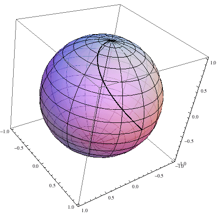

This isn't actually homework, but just related to something I am working on.
Basically I need to find the distance between two points along a sphere. Not the linear distance, but the distance along the surface.
This would be akin to "arc length" except in three dimensions.

You're totally on the right path. r = constant, therefore
[tex] dr = 0[/tex]
therefore
[tex] ds = r d\theta \hat{\theta} + r sin(\theta) d\phi \hat{\phi}[/tex]
but you also need to parametrize your theta a phi; i.e. a path is one dimensional, so you need to have only one free parameter (e.g. 't' for theta(t), phi(t) )
plug that parametrization into 'ds' above, and integrate over 't' (e.g.).
Because you're looking for the shortest distance (presumably), your solution will be a geodesic (or great circle in this case).

Your 3D equation is the vector equation
[tex]d\mathbf{s} = dr\,\mathbf{\hat{r}}+r\,d\theta\,\boldsymbol{\hat{\theta}}+r\sin \theta\,d\phi\,\boldsymbol{\hat{\phi}}[/tex]
for the line element. If you integrate ds, you'll get the vector s, not a distance. What you want is its length ds where
[tex]ds^2=d\mathbf{s} \cdot d\mathbf{s} = dr^2 + r^2 (d\theta^2+\sin^2\theta\, d\phi^2)[/tex]
(On a side note, in spherical coordinates, the unit vectors are not constant. They're functions of r, θ, and ϕ, so you can't just yank them out of integrals like you did.)

You wouldn't. It's probably easiest to see how you do this type of calculation by example.
Say the path is on the surface of a unit sphere and satisfies ϕ=θ where the angles run from ϕ=θ=0 to ϕ=θ=π/2. (See the attached plot.) On the surface of a sphere, r=1 is constant, so dr=0. Since ϕ=θ, we get dϕ=dθ. Let's use θ as the integration variable, so we'll get
[tex]\begin{align*}<br /> ds &=\sqrt{ds^2}=\sqrt{dr^2+r^2(d\theta^2+\sin^2\theta\,d\phi^2)} \\<br /> & = \sqrt{0^2+1^2(d\theta^2+\sin^2\theta\,d\theta^2)} \\<br /> & = \sqrt{1+\sin^2\theta}\,d\theta<br /> \end{align*}[/tex]
The length would therefore be given by
[tex]s=\int ds = \int_0^{\pi/2} \sqrt{1+\sin^2\theta}\,d\theta[/tex]
